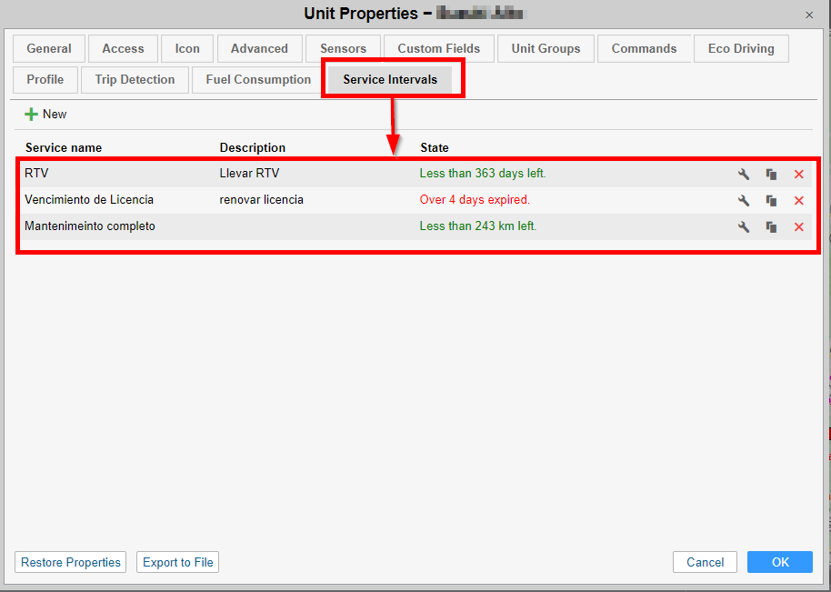

Hello everyone, I'm using JavaScript API.
I'm having problems to get the list of Service Intervals of a Unit. The thing is that I'm not sure if this is even possible using JS API, since the documentation about this is not provided.
I have tried to add the flag:
var flags = wialon.item.Item.dataFlag.base | wialon.item.Unit.dataFlag.maintenance;
But it doesn't help, i think is didn't exist. Do you know how I can get that list of Service Intervals?
I really really depreciate your help!!!
UPDATE:
There has been a while and I dont get answers. Please tell me if my question is not clear enogh? Or maybe it is just not possible?
Im also attaching an image that can help

Hi guys,
Can't seem to make this work.  We have created a couple of maintenance services but still producing null output.  Are there any prerequisites for this to work besides loading the library and adding the appropriate flags?  What I'm trying to get are the maintenance service interval list indicated in here: https://sdk.s-watcher.com/wiki/en/sidebar/
Tried using both hosting api and js api but to no avail.  We have the appropriate permission, and even used the top account.
Any help will be very much appreciated.  Thank you.
