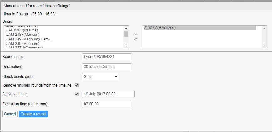

Our client is using routes & schedules to assign rounds to 1,500 drivers across 3 countries. They do not wish to use Wialon Logistics App because they found that this functionality of routes//schedules//rounds serves their interests better.
Everything is working fine expect for the fact that they cannot print the round details i.e. ETA of each check point in route.
After creating a manual round in the system, we want to give the driver notes for future reference during the course of the journey. Either we provide a hard copy print out of the check points and their estimated time of arrival ETA or we provide this information in an SMS sent to the driver or we push the information to a mobile terminal/mobile app. Printing seems the most basic of all the output options, so please let us start with this option.

I have attached here an example of data which we would like to see in the print out.
I am taking into consideration that at the point of hitting the print button,
(a)this data has either been entered by the customer  i.e. round details
(b)already exists in the route i.e. geo fences/check points/ schedule ETA details
(c) already exists in the unit details e.g. unit profile.

Tim.Mwandha, with unit profile info it becomes the other type of work. Can the info only about route solve your issue?
The list, that I suggest to be printed:
Round Name
Round Description
Date & Time of creating round
Activation time
Unit name
Route name
Schedule name
Schedule type
Check point names
Tatsiana Shmihelskaya

Re: Printing ETA of Check Points in Rounds
Tata,  please ignore unit profile,  and proceed with printing the listed round items as suggested.
Tim.Mwandha, schedule printing option is ready! Try it in Beta.
This absolutely fantastic!!
We are very delighted with this development.
Thanks a lot.
I have trained the actual users on how to print.
If there is any feedback, i will reply here in the next few days.
Otherwise it looks fine to me.
When can you commit the updated feature to the stable version?
timothy, Stable update is scheduled for today
