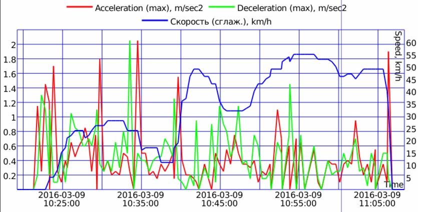

ECO Driving
Sample of Road Fuel Tanker Movement Parameters for ECO Driving
  • Eco Driving report template update
