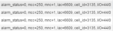

What is responsible for the input of the ignition ?
Photo data from the device attached.
  • concox GT06N
concox GT06N
Re: concox GT06N
danis Nobody (except you/your installer) knows about which input is connected to ignition circuit wire.
May be this parameter is coded into I/O parameter (I/O=44)
After understanding which input transmits your ignition  I advice you to learn more about "bitwise parameter control".
http://docs.gurtam.com/en/hosting/cms/u … sors/param

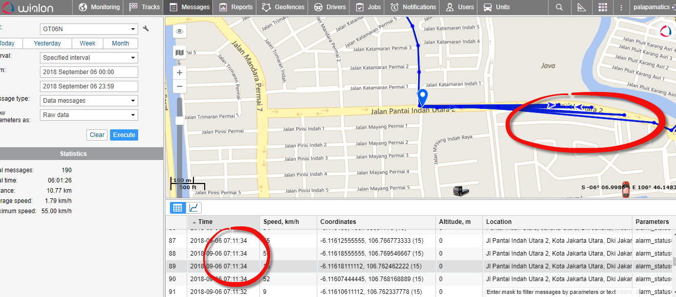

I am having the same issue as lpscolombia.
It appears that all 'old data' (stored data during no GPRS) have the same timestamp when being pushed back to the server after GPRS are re-established. *see attached picture.
I opened a support ticket and from the log it seems that it was sent that way by GT06N. There has to be a way to deal with this as I understand that in Tracksolid (the original platform), there is no such issue. It might be related to 'Information Serial Number' in its protocol doc or maybe there is something wrong in the integration.
I will try to email the hw guys and see if they can help.
  • concox GT06N
concox GT06N
Re: concox GT06N
bhalim, Concox devices contain configurable timezone setting that generates different time then server can expect. Some servers, e.g. flespi can read it from device during connection stage, some expects it in UTC timezone.
I recommend you to change this setting to UTC (zero) timezone to prevent any troubles in the future with any kind of server.
