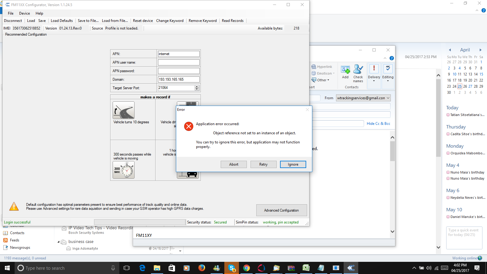

Hi Karma from Teltonika,
I updated firmware and when i tried to save configuration to device or run them from old file i got the error on pic attached. why does it happen.
What i should do now to make it work because now i cant save settings on devices?
Good Evening
I Follow recommendation provided by teltonika on forum and devices still do same things as before. I used terminal to get logs i attached here, one devices as two devices and you must look on both.
Also we updated firmware using the file you provided but i couldn't use configutator to save settings on devices because its give an error when try save.
