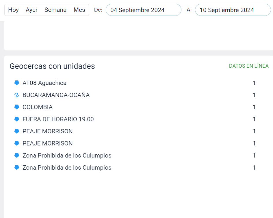

zant hello, i'm trying to replicate the dashboard of wialon, this one
