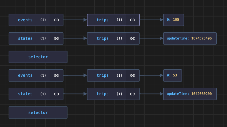

How can I do batch work for every unit in the system?
I'm trying to build the query string like this in Julia - code is very similar to python -
function batch_events(plates; week=43, year=2023)
    sid = ssid()
    monday = Dates.firstdayofweek(Week(week) + Date(Year(year)))
    sunday = Dates.lastdayofweek(Week(week) + Date(Year(year)))
    start  = datetime2unix(monday |> DateTime) |> Int32
    stop   = datetime2unix(sunday |> DateTime) |> Int32
    detectors = [

If call the function with the first two units like so
events = batch_events(plates[1:2]; week=43, year=2023)
It seems to be loading the events into session. But I'm not getting the actual data, although I've intercalated
:svc:{"events/get"}
requests.
In the image attached you can see a JSON crack image of the data I get
