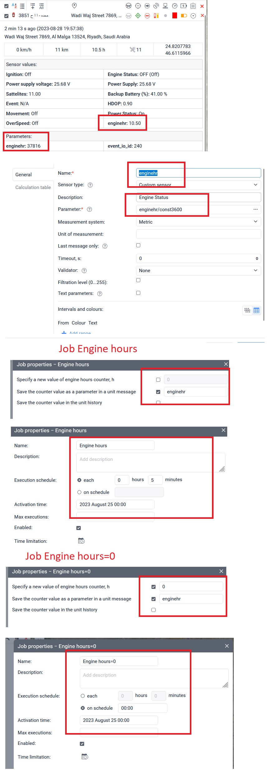

kindly check all setting because i think have a problem for calculation summation sensor engine hours.
for example now i have a different value from report and sensor
kindly check attachment for access photo ,sensor , job and notifications

alhajq the sensor works fine. I barely see the value at the screenshot, but they are probably:
37816seconds÷3600=10.5044hours
Parameter displays seconds. I therefore suggested adding const3600 into the sensor, to convert seconds into hours.

I already do the same settings on the sensor, but for example today, the reading of the report for operating hours is approximately 1 hour, but the reading of the operating hours counter is approximately 8 hours

alhajq change the Engine Status sensor from Ignition to Custom digital.
