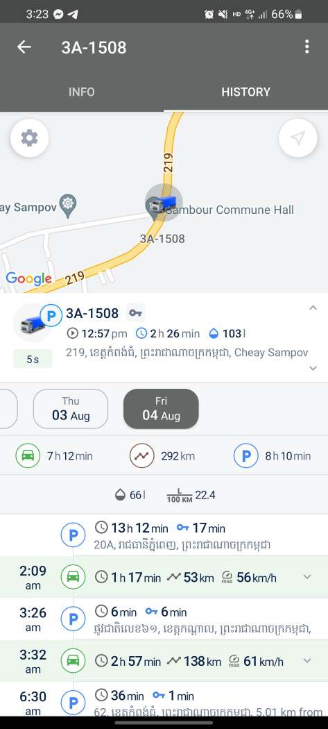

1. Is it possible request unit with geocode in per request :
    EX: https://hst-api.s-watcher.com/wialon/ajax.html?svc=core/search_items&params={"spec": {"itemsType": "avl_unit","propName":"sys_name","propValueMask": "*","sortType":"sys_name","or_logic":"0"},"force": 1,"flags":13644935,"from": 0,"to": 0}&sid=10ec4aa7b154a9fc0ac124fbf4d7537f

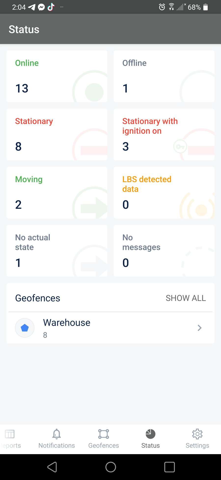

2. Could you advise me how to get all vehicle status as below:
  - Online
  - Offline
  - Stationary
  - Stationary with ignition on
  - Moving
  - LBS detected
  - No actual state
  - No Message

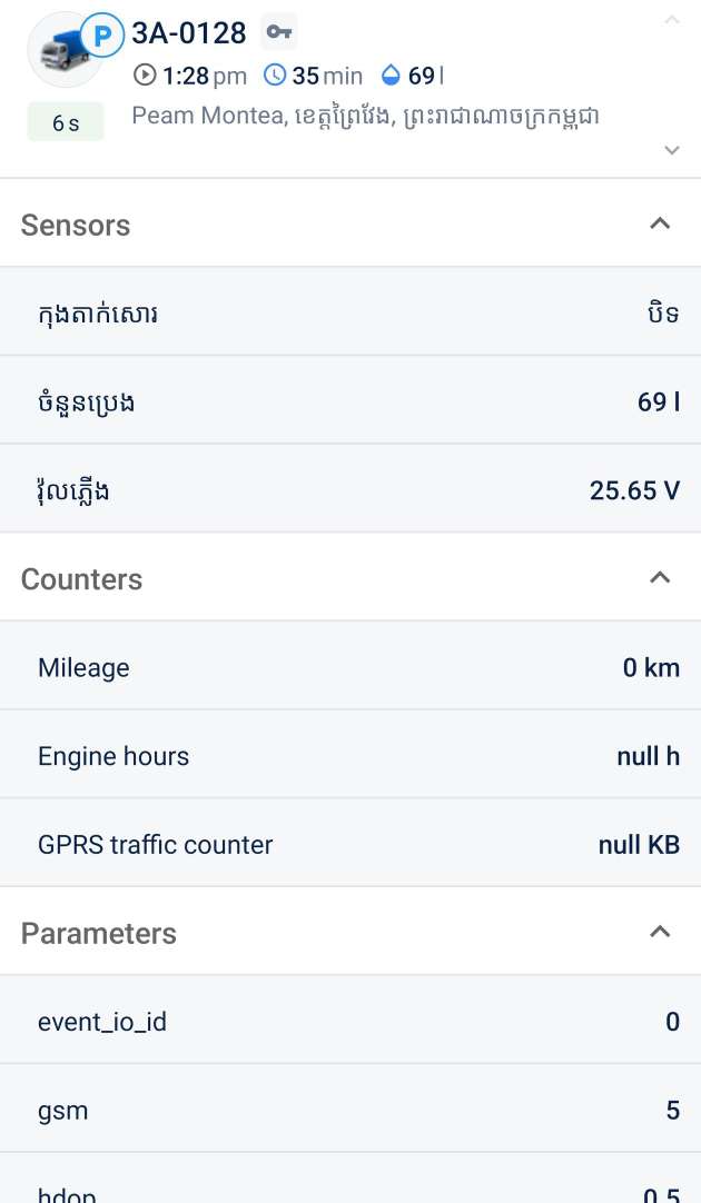

3. How to get Sensors status as below :
   - Ignition
   - Amount of fuel
Please kindly to check my attached file

chanden good day.
1. You can only get a coordinates with last location of the units. You need to add flags value of 1024. Then you can use coordinates into [code=https://sdk.s-watcher.com/wiki/en/sidebar/remoteapi/apiref/requests/address]gis_geocode[/code] request as pet the [code=https://sdk.s-watcher.com/wiki/en/sidebar/remoteapi/codesamples/address_coords]example[/code].
2. Most of the data can be received via search_items or search_item requests.
Online/Offline state regulates with 2097152 flags
Stationary/Moving state can be determine as per the speed value in the last message. Flag 1024
LBS detected, No actual state, No Message -- presumably, these states you can check requesting lat message with corresponding [code=https://sdk.s-watcher.com/wiki/en/sidebar/remoteapi/apiref/messages/load_last]request[/code].

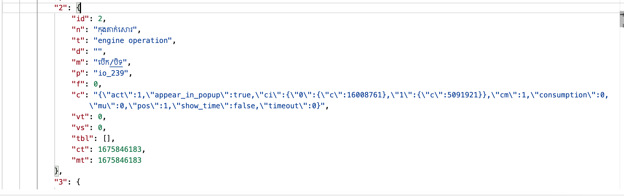

3. In order to get sensors values, you can use two different options:
- Via [code=https://sdk.s-watcher.com/wiki/en/sidebar/remoteapi/apiref/unit/calc_last_message]calc_last_message[/code] request. The reply shows sensors values from the last message by the sensors ID. In order to determine sensor ID you can use search_items request with flags value 4096
- you can use [code=https://sdk.s-watcher.com/wiki/en/sidebar/remoteapi/apiref/events/events]events[/code] to control sensors states changes. This option describe in the [code=https://www.youtube.com/live/nUtNS5Al5wo?feature=share]webinar[/code].

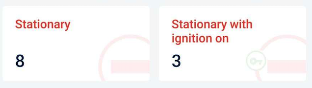

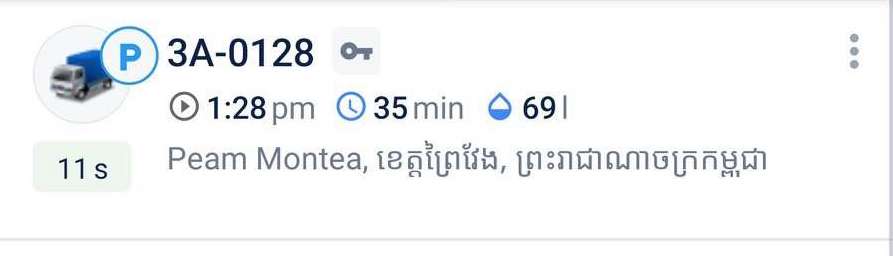

My problem not solve with stationary with ignition on .
Could you give an example how to count stationary and stationary with ignition on.

chanden hello, in order to determine such status you can control two values - ignition sensor value and speed value. Thus if the ignition is ON, but speed value is below minimum moving speed specified in the trip detector - this is stationary with Ignition ON.
