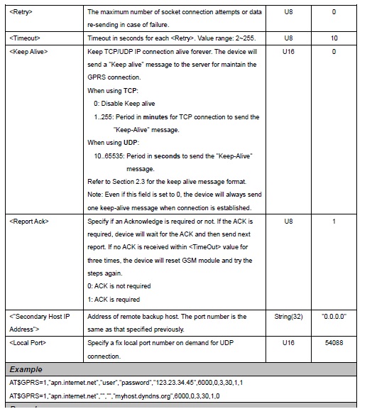

Hi all, please i would like to configure my Atrack AK1 unfortunately my cable is damaged so i would like to configure it by sms, can i have the full command of Atrack AK1 starting with: AT $ GPRS = ???
Thank you..

Hello,
kindly note you can check the attachment for Protocol AK1 and for more information, we can help you.
AT$GPRS=1,"APN","","","IP",Port,TCP/UPD,10,60,3600,1
