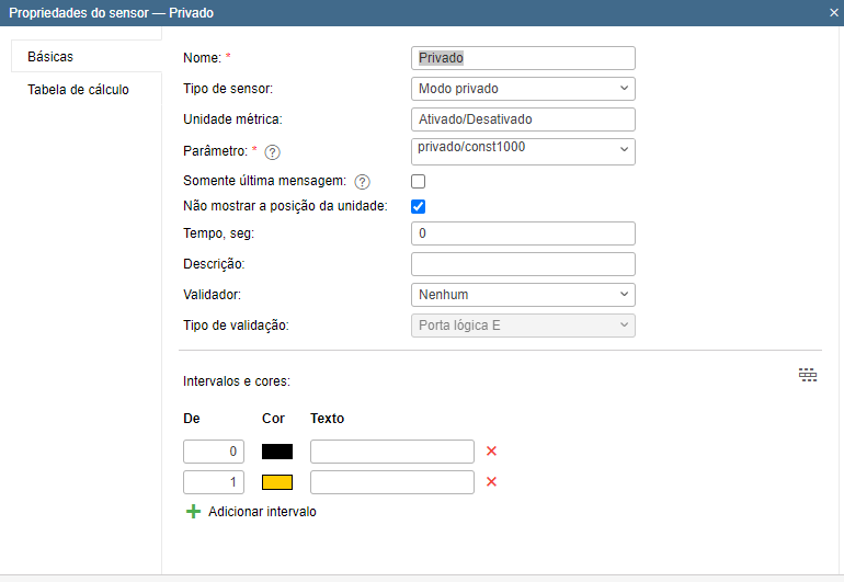

Unfortunately we do not have data filtration based on geofences. But you could use digital sensor "Private mode" instead. https://docs.s-watcher.com/en/hosting/cms/ … es#digital.
It has property "Do not show unit location" https://docs.s-watcher.com/en/hosting/cms/ … sors/props. With such sensor (if it is enabled) all messages, created while the sensor is enabled, are displayed without GPS coordinates. Works for new messages only.

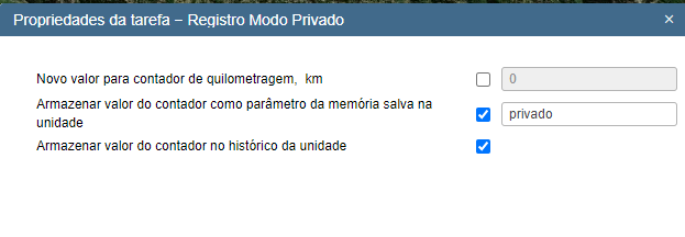

That's what we're using today. The client doesn't need the counter mileage:
01) we created a task to register the counter;
02) created a sensor "Private mode" based on the parameter that has been registered;
03) when the client want to enable the private mode, he change the counter to "1", when he wants to disable, changes to "0".
