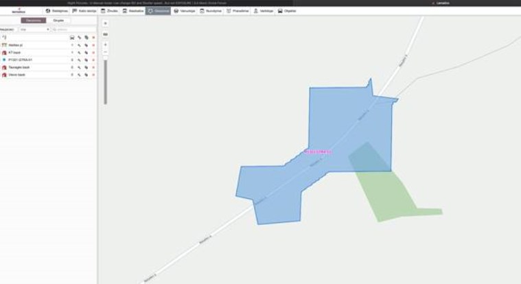

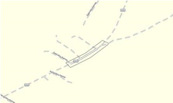

One of our client tries to create geozones using SDK. Anyway there is some kind a problem because after import geozone looks different then it should look (tested on google earth and manual geozone import). What does client doing wrong?
We are making steps like info bellow:
- Using KML file (attached bellow);
- We read coordinates from tag <coordinates>;
- then we are using service https://sdk.s-watcher.com/wiki/en/sidebar/ … pdate_zone to create new geozone with coordinates from KML file.
- We present request with these parameters id = 0, callMode = create, n,d, t = 2, f =112, w = 300, c = 2566940364, p – coordinates (where r = 300);
Attached examples and KML.

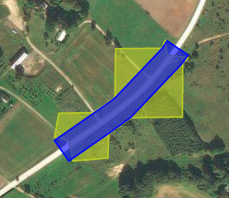

With our request there is something wrong. There is difference between coordinates. Is there any rule regarding KML? We just take the list of coordinates from KML and transfer it. Maybe there is some kind order of location points to transfer via request?
Our parameters:
params={"itemId":16923442,"id":0,"callMode":"create","n":"Testas","d":"TESTdescription","t":2,"f":112,"w":300,"c":2566940364,"p":[{"x":23.8812222454,"y":54.6926217199,"r":300},{"x":23.8817351861,"y":54.6925845791,"r":300},{"x":23.8816915525,"y":54.6925446569,"r":300},{"x":23.8816445956,"y":54.6925420845,"r":300},{"x":23.8816414998,"y":54.6925320611,"r":300},{"x":23.8816294305,"y":54.6925227444,"r":300},{"x":23.8816181876,"y":54.6925123565,"r":300},{"x":23.8816056009,"y":54.6925062649,"r":300},{"x":23.8815981848,"y":54.6917325339,"r":300},{"x":23.8803270751,"y":54.6917242999,"r":300},{"x":23.8803088701,"y":54.6917160128,"r":300},{"x":23.8802904130,"y":54.6917077757,"r":300},{"x":23.8802719358,"y":54.6916995872,"r":300},{"x":23.8802534408,"y":54.6916914459,"r":300},{"x":23.8802349299,"y":54.6916833506,"r":300},{"x":23.8802164052,"y":54.6916753000,"r":300},{"x":23.8801978684,"y":54.6916672928,"r":300},{"x":23.8801793218,"y":54.6916593276,"r":300},{"x":23.8801607670,"y":54.6916514033,"r":300},{"x":23.8801422060,"y":54.6916435183,"r":300},{"x":23.8801236407,"y":54.6916356715,"r":300},{"x":23.8801050729,"y":54.6916278615,"r":300},{"x":23.8800865044,"y":54.6916200870,"r":300},{"x":23.8800679369,"y":54.6916123467,"r":300},{"x":23.8800493724,"y":54.6916046393,"r":300},{"x":23.8800308124,"y":54.6915969634,"r":300},{"x":23.8800122587,"y":54.6915893178,"r":300},{"x":23.8799937130,"y":54.6915817011,"r":300},{"x":23.8799751771,"y":54.6915741120,"r":300},{"x":23.8799566525,"y":54.6915665493,"r":300},{"x":23.8799381409,"y":54.6915590115,"r":300},{"x":23.8799196439,"y":54.6915515465,"r":300},{"x":23.8799012839,"y":54.6915440487,"r":300},{"x":23.8798828060,"y":54.6915365720,"r":300},{"x":23.8798643476,"y":54.6915291152,"r":300},{"x":23.8798459102,"y":54.6915216769,"r":300},{"x":23.8798274954,"y":54.6915142559,"r":300},{"x":23.8798091047,"y":54.6915068509,"r":300},{"x":23.8797907396,"y":54.6914994606,"r":300},{"x":23.8797724018,"y":54.6914920837,"r":300},{"x":23.8797540927,"y":54.6911468812,"r":300},{"x":23.8788972901,"y":54.6911034402,"r":300},{"x":23.8787901109,"y":54.6913979188,"r":300},{"x":23.8784344284,"y":54.6914416482,"r":300},{"x":23.8785423186,"y":54.6917871361,"r":300},{"x":23.8793998264,"y":54.6917944886,"r":300},{"x":23.8794180751,"y":54.6918018302,"r":300},{"x":23.8794362921,"y":54.6918091621,"r":300},{"x":23.8794544758,"y":54.6918164856,"r":300},{"x":23.8794726249,"y":54.6918238018,"r":300},{"x":23.8794907377,"y":54.6918311120,"r":300},{"x":23.8795088129,"y":54.6918384175,"r":300},{"x":23.8795268488,"y":54.6918457194,"r":300},{"x":23.8795448442,"y":54.6918530741,"r":300},{"x":23.8795629330,"y":54.6918603787,"r":300},{"x":23.8795808577,"y":54.6918676832,"r":300},{"x":23.8795987372,"y":54.6918749890,"r":300},{"x":23.8796165702,"y":54.6918822971,"r":300},{"x":23.8796343552,"y":54.6918896088,"r":300},{"x":23.8796520907,"y":54.6918969251,"r":300},{"x":23.8796697752,"y":54.6919042472,"r":300},{"x":23.8796874072,"y":54.6919115762,"r":300},{"x":23.8797049853,"y":54.6919189133,"r":300},{"x":23.8797225080,"y":54.6919262595,"r":300},{"x":23.8797399738,"y":54.6919336159,"r":300},{"x":23.8797573812,"y":54.6919409837,"r":300},{"x":23.8797747287,"y":54.6919483638,"r":300},{"x":23.8797920147,"y":54.6919557573,"r":300},{"x":23.8798092379,"y":54.6919631653,"r":300},{"x":23.8798263966,"y":54.6919705888,"r":300},{"x":23.8798434893,"y":54.6919780288,"r":300},{"x":23.8798605145,"y":54.6919854863,"r":300},{"x":23.8798774707,"y":54.6919929623,"r":300},{"x":23.8798943562,"y":54.6920004578,"r":300},{"x":23.8799111695,"y":54.6920079737,"r":300},{"x":23.8799279091,"y":54.6920156124,"r":300},{"x":23.8799447978,"y":54.6927133963,"r":300},{"x":23.8810911404,"y":54.6927191589,"r":300},{"x":23.8810981559,"y":54.6927289363,"r":300},{"x":23.8811100027,"y":54.6927378202,"r":300},{"x":23.8811207232,"y":54.6927476194,"r":300},{"x":23.8811325223,"y":54.6927486135,"r":300},{"x":23.8811337187,"y":54.6927867815,"r":300},{"x":23.8811786120,"y":54.6928239225,"r":300}]}
Your parameters:
params={"n":"Polygon","d":"Laatzen 30880, Lange Weihe","t":2,"w":300,"f":112,"c":2566914303,"tc":16733440,"ts":12,"min":0,"max":18,"p":[{"x":23.8812222455,"y":54.6928239225,"r":300},{"x":23.8817351862,"y":54.6926217199,"r":300},{"x":23.8816915525,"y":54.6925845792,"r":300},{"x":23.8816445957,"y":54.692544657,"r":300},{"x":23.8816414998,"y":54.6925420846,"r":300},{"x":23.8816294305,"y":54.6925320611,"r":300},{"x":23.8816181876,"y":54.6925227444,"r":300},{"x":23.881605601,"y":54.6925123565,"r":300},{"x":23.8815981848,"y":54.6925062649,"r":300},{"x":23.8803270751,"y":54.691732534,"r":300},{"x":23.8803088702,"y":54.6917242999,"r":300},{"x":23.880290413,"y":54.6917160129,"r":300},{"x":23.8802719359,"y":54.6917077758,"r":300},{"x":23.8802534409,"y":54.6916995872,"r":300},{"x":23.88023493,"y":54.6916914459,"r":300},{"x":23.8802164052,"y":54.6916833507,"r":300},{"x":23.8801978685,"y":54.6916753001,"r":300},{"x":23.8801793218,"y":54.6916672928,"r":300},{"x":23.880160767,"y":54.6916593277,"r":300},{"x":23.8801422061,"y":54.6916514033,"r":300},{"x":23.8801236408,"y":54.6916435184,"r":300},{"x":23.8801050729,"y":54.6916356716,"r":300},{"x":23.8800865044,"y":54.6916278616,"r":300},{"x":23.880067937,"y":54.6916200871,"r":300},{"x":23.8800493724,"y":54.6916123468,"r":300},{"x":23.8800308124,"y":54.6916046393,"r":300},{"x":23.8800122587,"y":54.6915969635,"r":300},{"x":23.8799937131,"y":54.6915893178,"r":300},{"x":23.8799751771,"y":54.6915817011,"r":300},{"x":23.8799566525,"y":54.6915741121,"r":300},{"x":23.8799381409,"y":54.6915665493,"r":300},{"x":23.879919644,"y":54.6915590116,"r":300},{"x":23.8799012839,"y":54.6915515466,"r":300},{"x":23.8798828061,"y":54.6915440488,"r":300},{"x":23.8798643477,"y":54.6915365721,"r":300},{"x":23.8798459103,"y":54.6915291153,"r":300},{"x":23.8798274955,"y":54.691521677,"r":300},{"x":23.8798091047,"y":54.691514256,"r":300},{"x":23.8797907397,"y":54.691506851,"r":300},{"x":23.8797724019,"y":54.6914994607,"r":300},{"x":23.8797540927,"y":54.6914920838,"r":300},{"x":23.8788972901,"y":54.6911468812,"r":300},{"x":23.878790111,"y":54.6911034403,"r":300},{"x":23.8784344285,"y":54.6913979189,"r":300},{"x":23.8785423187,"y":54.6914416482,"r":300},{"x":23.8793998264,"y":54.6917871361,"r":300},{"x":23.8794180752,"y":54.6917944886,"r":300},{"x":23.8794362921,"y":54.6918018302,"r":300},{"x":23.8794544759,"y":54.6918091622,"r":300},{"x":23.8794726249,"y":54.6918164856,"r":300},{"x":23.8794907377,"y":54.6918238019,"r":300},{"x":23.8795088129,"y":54.6918311121,"r":300},{"x":23.8795268489,"y":54.6918384175,"r":300},{"x":23.8795448443,"y":54.6918457194,"r":300},{"x":23.8795629331,"y":54.6918530742,"r":300},{"x":23.8795808577,"y":54.6918603787,"r":300},{"x":23.8795987373,"y":54.6918676833,"r":300},{"x":23.8796165703,"y":54.691874989,"r":300},{"x":23.8796343552,"y":54.6918822972,"r":300},{"x":23.8796520907,"y":54.6918896088,"r":300},{"x":23.8796697752,"y":54.6918969251,"r":300},{"x":23.8796874073,"y":54.6919042472,"r":300},{"x":23.8797049854,"y":54.6919115763,"r":300},{"x":23.8797225081,"y":54.6919189133,"r":300},{"x":23.8797399739,"y":54.6919262595,"r":300},{"x":23.8797573812,"y":54.691933616,"r":300},{"x":23.8797747287,"y":54.6919409837,"r":300},{"x":23.8797920148,"y":54.6919483638,"r":300},{"x":23.8798092379,"y":54.6919557574,"r":300},{"x":23.8798263966,"y":54.6919631654,"r":300},{"x":23.8798434894,"y":54.6919705889,"r":300},{"x":23.8798605146,"y":54.6919780289,"r":300},{"x":23.8798774707,"y":54.6919854864,"r":300},{"x":23.8798943562,"y":54.6919929624,"r":300},{"x":23.8799111696,"y":54.6920004578,"r":300},{"x":23.8799279092,"y":54.6920079737,"r":300},{"x":23.8799447979,"y":54.6920156125,"r":300},{"x":23.8810911404,"y":54.6927133964,"r":300},{"x":23.8810981559,"y":54.692719159,"r":300},{"x":23.8811100027,"y":54.6927289363,"r":300},{"x":23.8811207233,"y":54.6927378203,"r":300},{"x":23.8811325224,"y":54.6927476194,"r":300},{"x":23.8811337187,"y":54.6927486135,"r":300},{"x":23.8811786121,"y":54.6927867816,"r":300}],"id":165,"itemId":930849,"callMode":"update"}
As we have analyzed x coordinates the same but y coordinates different. How could it happen as i do not see difference in KML file?
Also attaching picture with different results. Our result in yellow color. The difference are huge.

Hello!
as I see it's not correct pairs X and Y  in your parameters
For example, first point - 23.88122224546052,54.69282392251598 in klm, in request - {"x":23.8812222455,"y":54.6928239225,"r":300}
But in your request this point is {"x":23.8812222454,"y":54.6926217199,"r":300}. As you see the other value for Y
the same for second point - 23.88173518617861,54.69262171990643 in klm, in request  {"x":23.8817351862,"y":54.6926217199,"r":300}
your point - {"x":23.8817351861,"y":54.6925845791,"r":300}
it seems like you parse coordinates from KML not correctly. The format is X1,Y1,radius X2,Y2,radius X3.....
Coordinates are separated by coma, each points are separated by space after radius
Geozones import via SDK problem
