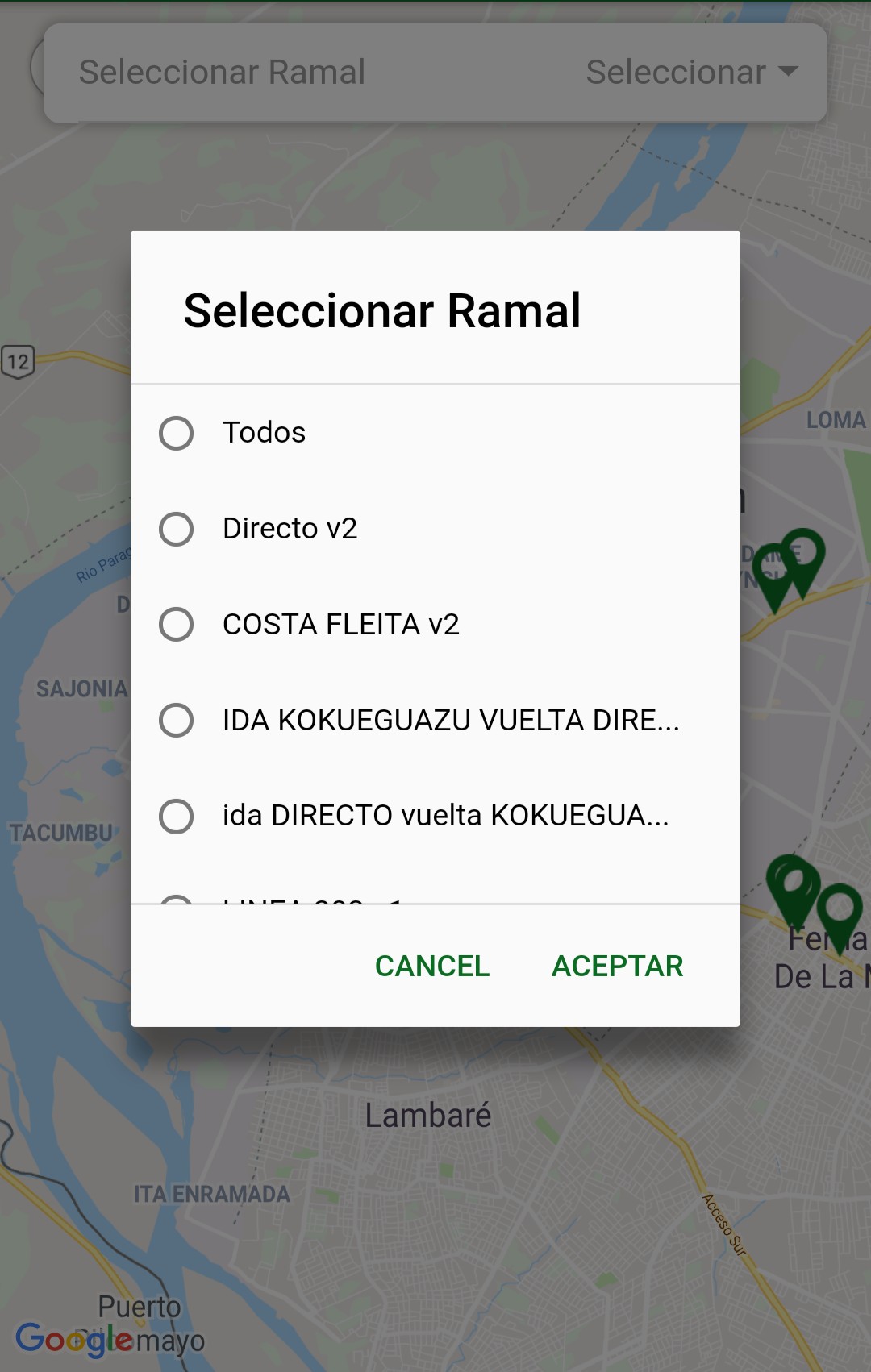

My goal is to know when a unit belongs to the 2DIR route or to route 3-1 (of somes routes, we have six routes), as seen in the image.

The objective we have is the following:
1 - Show in an application the position of the units
2 -View routes and stops
3 - Filter the units that are associated with the routes or stops.
4 - Obtain the estimated time of arrival of a unit, to a stop
So far we were able to show the units in real time (point 1) and only visualize the routes (point 2), but not the relationship between units and routes/stops.
Currently my server is making a query to the positions of the units every 5 seconds and the application is connected to my server through websocket.
Get route associated with a unit
Attached examples of the application that consumed the processed data
