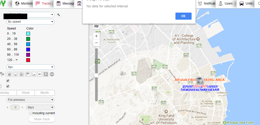

Hello, Dears, I meet this case with my customer. the last update date for one unit for example from 7 days. and when you went to see the track for this unit for 8 or 10 days. system display message  "no data at this interval" but when you search for previous 60 days. it gives data and draws the track. the main question here. why it gives no data on the interval for 7 or 10 days. without any last location for this unit
According to your second screenshot you have activated option "Trip Detector". It means tracks will be shown only for trips (not for all messages). So most likely you should check the settings of trip detector.

thanks i know this method but when i searched in messages i found that GPS messages contain only engine is off
