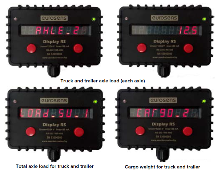

■ Show axle load and cargo weight at the driver’s display.

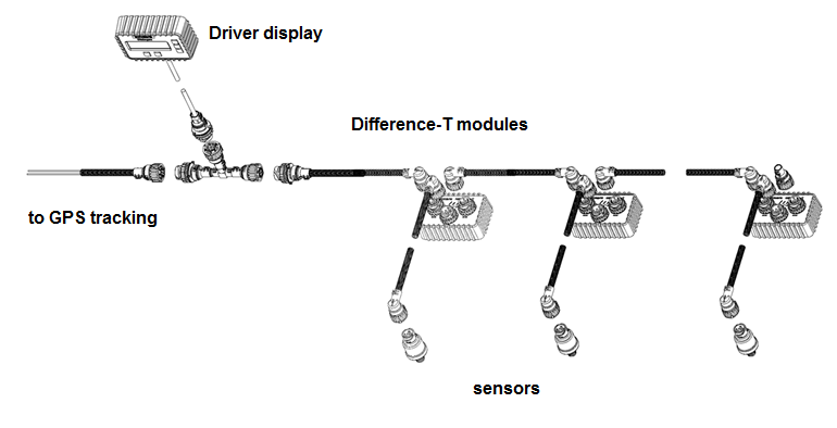

Eurosens Difference system consist from:
1. Sensors. You can use Mechatronics sensors or any other with voltage output.
2. Difference-T controllers
3. Display
All calibrations, calculations are made by Eurosens Difference, so GPS tracker will receive ready data:  axle loads, cargo weight.

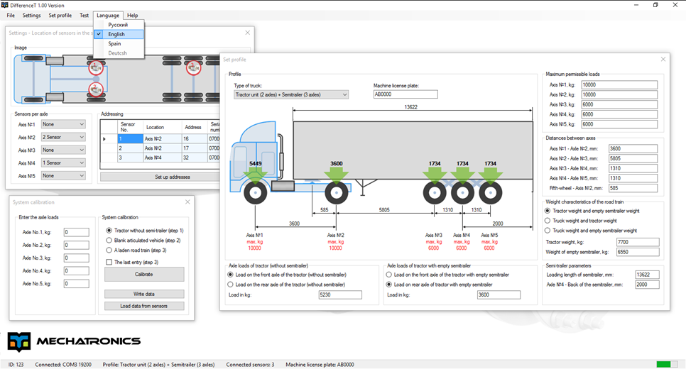

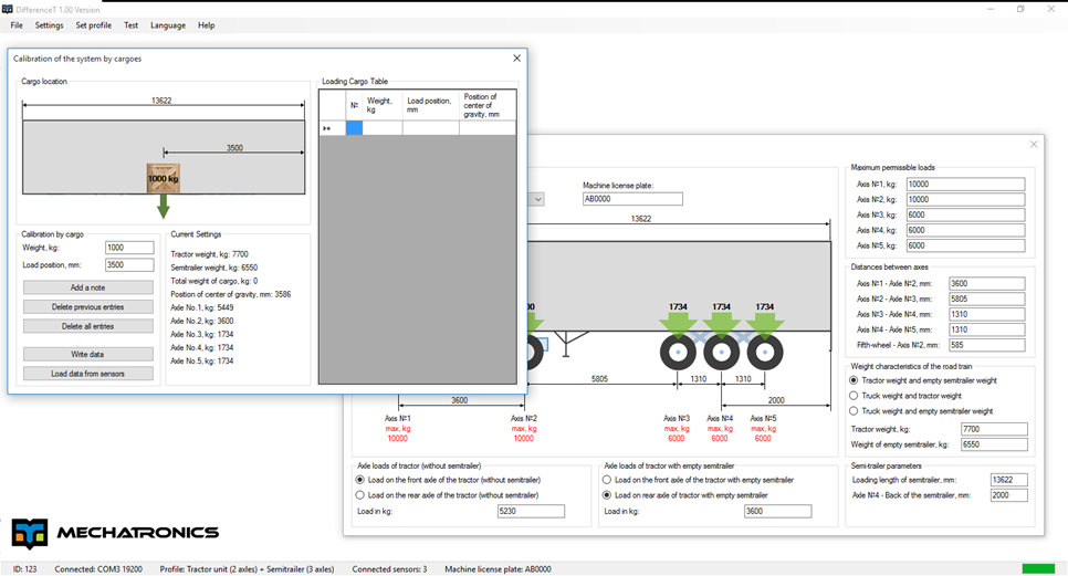

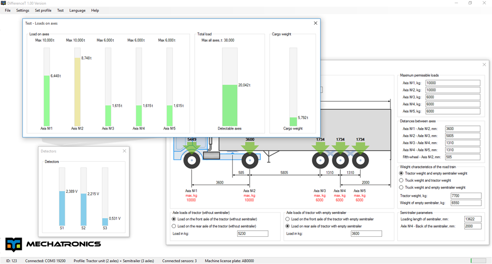

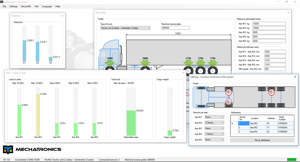

Configuration is made by service software Eurosens Difference Configurator

Important information :
1. Each analog sensor is connected via a Difference-T controller.
2. The protocol of axle load transfer from Difference-T: LLS, each sensor under its own address (0-5).
3. If it is not necessary to measure the weight of the cargo (and warning about exceeding the axle load) - Display is not necessary.
4. The protocol for transferring cargo weight from Display: LLS (addresses 8-9, tractor and trailer)
5. When changing the semitrailer , the system continues to work if the new semitrailer is also equipped with sensors and Difference-T (with calibration).
     No reconfigurations are required.
