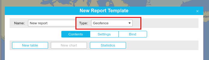

Hello teerak,
A new report type "Geofence" is already available. Please, try it and leave your feedback.

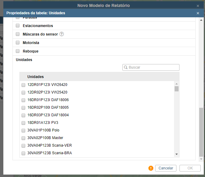

I have some clients already using these report types, so I have two suggestions that maybe could make the reports easy to generate.
1. Allow the reports of group of geofences execute geofences too (like group of units can generate by a unit);
2. Remove the obligation to select vehicles (no unit selected = report get data from every unit).
Thank you!

1) I guess it has sense. Groups of geofences are rather dynamic elements as well as groups of units. And indeed, there is often a need to change their composition. For the convenience of reporting and eliminating the need to create a large number of geofence groups, it would be convenient to allow in reports on groups to select and geofences outside the groups.
2) This is our standard selection mechanism, which works in many tables. We have not received such a request before, so I would like to clarify the following: what exactly is inconvenient about this selection?
Performing a report on all elements at once can put an unnecessary strain on the system.  In my opinion, when executing the report, the user should understand which elements he wants to get information on, i.e. it should be a conscious choice. And if the user really wants to run the report on all the units at once, he just needs to use the 'ctrl' button to select all.

Hello mana  smile
1) Yes, thank you!
2) I've already mentioned something about this on this topic: https://forum.gurtam.com/viewtopic.php?id=15447
When a new geofence is created, if you doesn't bind in a group, you'll have to open the report every time and select it, the same happen to vehicles, and for clients that doesn't know the platform very well, complains that the report creation/generation isnt't working right.

I carefully read your previous request. hasan.ahmed offered you the following:
create a group of geofences (called A) and add all geofences that you want to it,  change the setting of the report to make it work only on group A.
any new geofence should be added to the group and the report will work perfetly.
It is my understanding, this option suitable to you. In this regard, I have a question for you: if we added the ability to select not only an unit, but also a group of units in the report settings, would this help you to solve the problem and avoid complaints from customers?
Also, I want to point out once again that it is a bad solution to run a report on all units, because it can put a lot of load on the system and significantly increase the report run time.
Nastassia Maslovskaya
Business Analyst, Wialon
Report On Geofence or Group Of Geofence
Re: Report On Geofence or Group Of Geofence
Hello mana,
Yes, despite I still think that not needing to select every unit is the best solution (generally, when a client create a report, he most of the times wants to know about every units), it will help. smile

Hello mana, how are you?
Is it possible to add this filter like we have in reports units>geofence?
I have a client that needs to know the time inside the geofences with engine on, but report from Geofences is better for them.

Hello Fernando Brochetto,
I took note of your proposal because it makes sense.
We want to analyze all our tables and add to them all the necessary filters that are missing.
