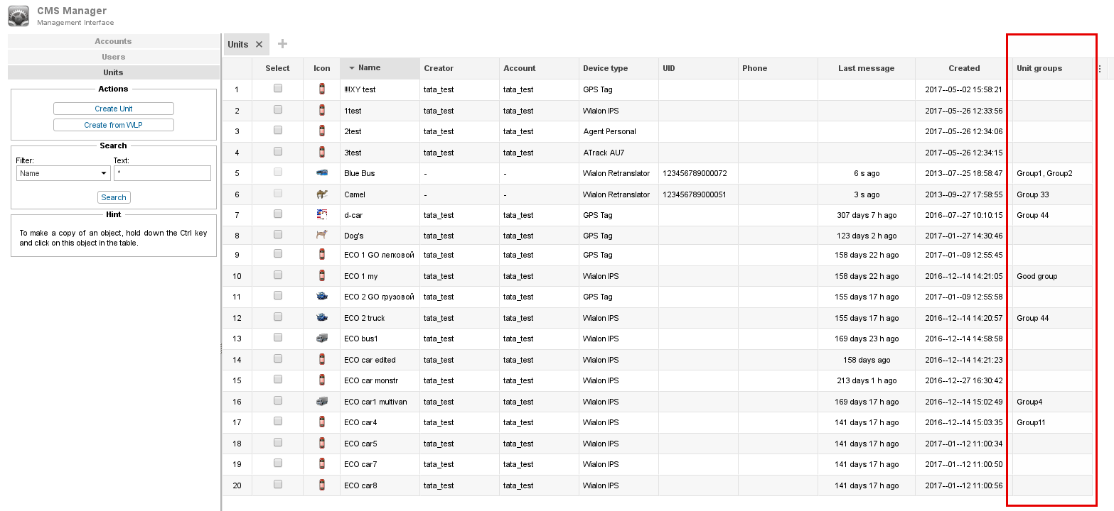

I'd suggest the improvement like on the screenshot: to add a column of Unit groups to the Unit table in CMS.

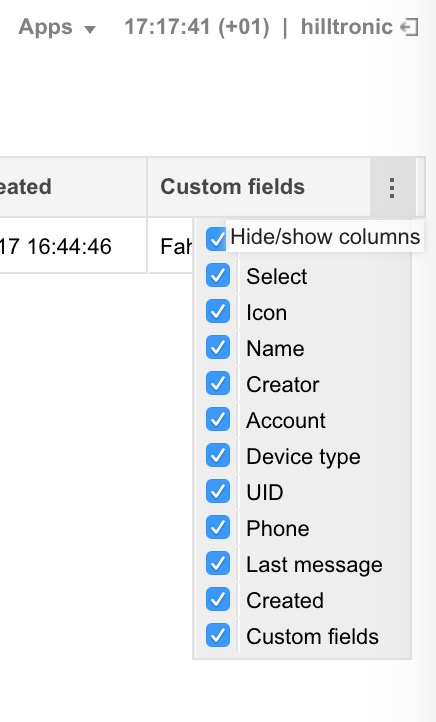

Hi Tatsiana,
the strange thing is, that i do not have column "Unit Groups" in CMS and can also not add it. That would already solve 90% of my problems!
(see screenshot).
Unit latest data does not give unit groups and custom fields.
So how can i get this column Unit groups in CMS/Units?

wwbusch aka Buwo , it's not ready, it's just my suggestion what we can do. If it's OK, than we will plan this improvement.
While a unit can be in more than one group how you want to show it in CMS?
I think, that they should be displayed in the same way as the Custom Fields column, so groups will be divided by comma

Good news for you Wolf!
“Units” tab in CMS Manager has been supplemented with “Unit groups” column. The new column contains the groups a unit belongs to.
For convenient work with third-party applications, we also added the option to export “Unit groups” column to .xlsx.
