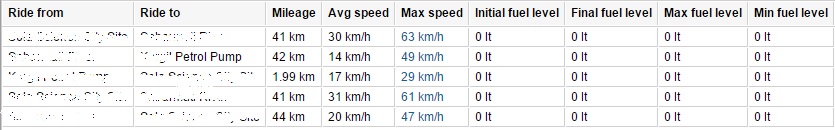

Hello,
I used analog fuel level sensor and its readings are completely observed in unit tool tip. It is oaky. Client want report of fuel level in geofences. At every geofences he want fuel level report. i made a ride report and select initial fuel level, final fuel level but it showing 0.00 litre. What is the problem ? Where I do mistake ?

Re: Fuel Level in Ride report
is Enabled Fuel control in fuel tab?
sales.gps.zoom пишет:
Hello,
Hello!
You need to enable option Fuel Level Sensors  at unit's properties on Tab Fuel Consumption
https://docs.s-watcher.com/en/hosting/cms/ … el_sensors
I enabled Fuel level sensor in Tab Fuel Consumption, i got the data in report and track history as well but it is wrong information getting. client vehicle fill fuel once a day but in track history it shows many time fuel filling marks and theft marks too. what is the setting we should change for this ?Please help.
sales.gps.zoom , please write to support@gurtam.com - unit name, report name and interval with errors
are treshold setup already? please give us more info = more help
If you provide some fuel graphs showing fuel thefts or fillings may help us to examin the issue.
