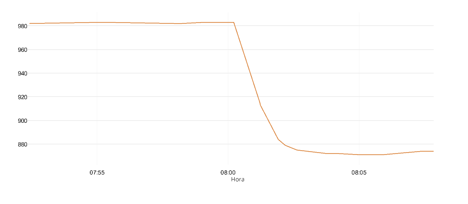

Hi,
I have a problem with a digital fuel sensor with RS232 output. The sensor has a sudden rise when the vehicle is finished parking. If we change the position just to ACC, the sensor doesnt go back to the level we had. When we start the engine, then the level sensor fall to the original level we had. We already changed the sensor, but did it again. Checked the lines and connections. Now, we changed the AVL to see if thats the problem.
Have you had a similar problem? What else could be?
