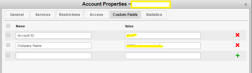

Hi
In Javascript API how to get the Custom fields of an Account using logged in users object.
I have attached the screenshot of the account custom fields
Thanks
  • How to upload an app into account Gurtam?
Thanks
J Prabhu
(04/10/2016 16:52:32 отредактировано deal)
Re: How to upload an app into account Gurtam?
prabhu.janakiraman, to get user's account custom fields use such request:
var accountId = wialon.core.Session.getInstance().getCurrUser().getAccountId();
wialon.core.Session.getInstance().searchItems({itemsType:"avl_resource",propName:"sys_id",propValueMask:accountId,sortType:""}, 1, 137, 0, 0, function(code, data) {
console.log(data);
137 - flags:
0x00000001 - base flag
0x00000008 - custom fields

It is working fine Thanks so much. But only after doing the below 2 steps only i get the custom fields as per your code logic. we should first load the custom fields library then we should update the session flags to fetch the customfields properties then if we call your code it is working fine.
var session = wialon.core.Session.getInstance();
session.loadLibrary("itemCustomFields");
var flags = wialon.item.Item.dataFlag.base | wialon.item.Item.dataFlag.billingProps | wialon.item.Item.dataFlag.customFields;
setupPayment.session.updateDataFlags( // load items to current session
                [{ type: "type", data: "avl_resource", flags: flags, mode: 0 }], // Items specification
                function (code) {
             //here we can have your code to get the custom fields data
Thanks
J Prabhu

prabhu.janakiraman, if You use updateDataFlags there is no need to make additional requests (searchItems):
                function (code) {
var res = wialon.core.Session.getInstance().getItem(accountId);
var customFields = res.getCustomFields();
console.log(customFields);
