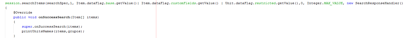

I use this dataFlag but i can't get data Unit. I don't know if this is an error because i'm trying with all dataFlags sad
I hope your comments.
Thanks!
UniqueID
(edited by Desarrollo 07/10/2015 23:55:43)
Re: UniqueID

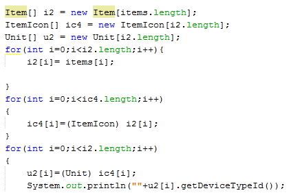

Here is the code

Desarrollo Please check access type for token, which you use.

Thank you so much!! I changed properties to generate token and its working!
