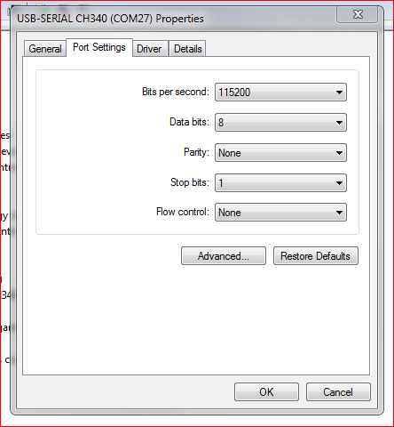

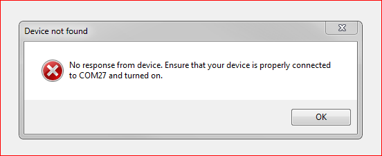

Hello
Cant connect teltonika fm4100 to the PC. İts says
Please Help!

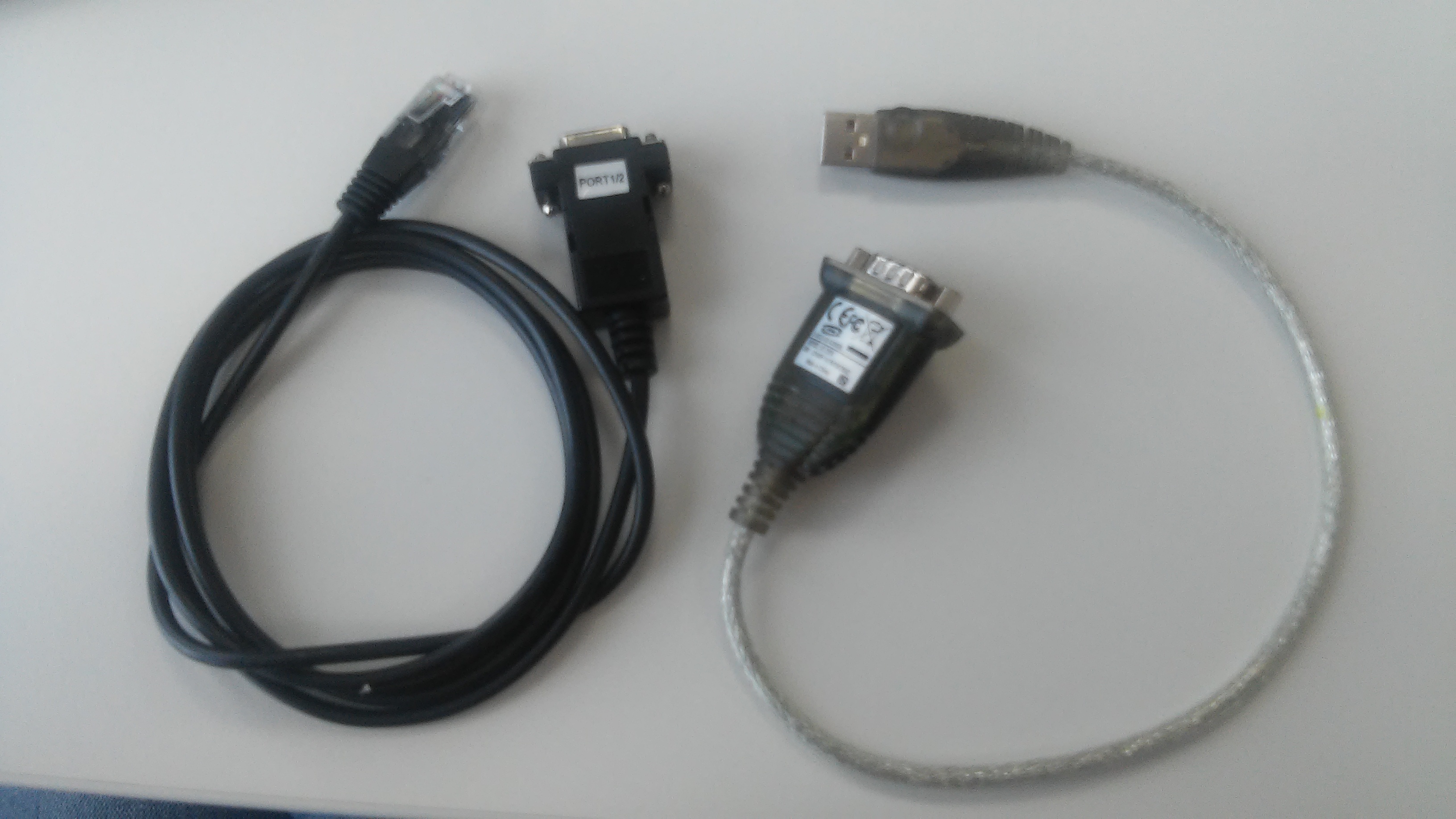

Re: Teltonika FM4100
EminEK Which exactly data cable do you use?
Please see attach
If you have COM port on your device you should use LAN-COM cable.
If you don't have COM port you also should have USB-to-COM adapter  (don't forget to install the driver for this item and check the number of com port)

Thanks for answer yavi.
Im using both of them. (USB-to-COM and original Teltonika cable for configuration)
Whats interesting there is no problem to connect another Fm4100 devices to my notebook which also means that drivers are ok.

Teltonika FM4100
yavi wrote:
Try to check the number of COM port (In Windows device manager, tool which is responsible for USB-to-COM adapter). May be the number of com port is changed?
Here is the settings of port
  • Teltonika FM4100
Teltonika FM4100
It seems that smth is wrong with exactly this device...
