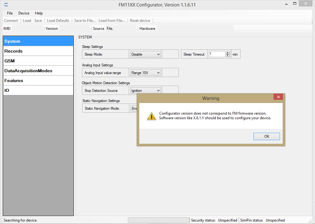

I have a problem with FM11XX_Configurator_v1.1.6.3  That can't config my device.
popup error "device firmware not support " How I get device firmware for use with FM11XX_Configurator_v1.1.6.3 ??
or any way to do with my device ??
Teltonika FM1100
Re: Teltonika FM1100
Please read this section

-_-''  Thank for you reply but I can't read russia!!  :-(
I try google translate That to really BAD.
Teltonika FM1100
I've sent you the latest firmware for your version of the configurator. Please check your e-mail.

I want to configure FM 1100 for a in lab project. When I connect it with my laptop for configuration, i get the error message for using some kind of configurator which I could not find so far.  Can someone guide me please? I have attached the screenshot of the error message.

Hi,
Read the txt carefully on the picture !! You only need a new configurator. Contact your supplier of the Teltonika units

Hi Baltika
Thank u for ur guidance. However, have not been able to reach the correct person to get the right configrator.
Can some help me find it on the internet some where? OR it is a compulsion to get it from where I bought the device?

Hi pervaizbutt,
You will not find on internet, give me a PM or Skype   and I will handover to you
My Skype: hsrutgers
regards

if you know your Firmware version , I can send it to you. Or try to find the firmware updater in your zip file.
Regards
EQ

i think it would be much more easier just to flash latest FW and than use the correct configurator ;-)
But harms, the x.8.x firmware, what special functions does it has?
Wolf.
Teltonika FM1100
Hi Wolf,
We have the best experience with the 10 version ...  we use this for the FM11xx series ..
It  solves the GPS problems as you can have with the other/older versions.
regards
Baltika
Hello guys. I just got a teltonika fm1100 and i am struggling to configure it via usb cable.
For the usb config i downloaded some configurator tools from their website but i get this error:
"Configurator version does not correspond to FM firmware version. Software version like X.1.11.Y should be used to configure your device".
Ok so i understand that i need a certain version of the config tool. My device has Code ver: 01.11.07 and i cannot find anywhere this configurator version.
Does anybody else had this problem and has the recommended config tool?
Thanks!
130
Teltonika FM1100
Hi florin.stana,
This not a problem, just ask your supplier of your FM11xx unit ..
regards

for TELTONIKA FM 1100 with available configurator always show the message "Configurator version does not correspond to FM Firmware version. Software version like X.8.5.Y should be used to configure your device"   I need supported configurator version or standard firmware and configurator
for Help Thanks a lot in advance My email is: lineofaction11@gmail.com

Hi,
Maybe contact Teltonika ?
regards

Hi Fay,
ask your Gurtam Sales Person for contact details from me, if you are a Gurtam partner/customer, i will help you with that.
Wolf.
