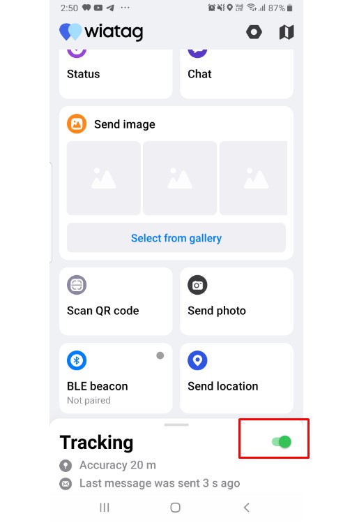

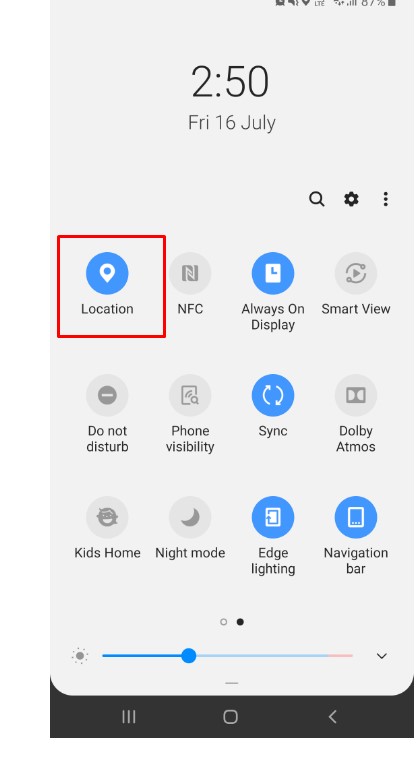

We use wiatag for new clients . .  The employees have been given an Android tablet to use as Wiatag.
The employee sometimes turns off the GPS signal
Sometimes it says the battery is discharged.
The official wants notifications about the GPS off and also when the battery charge reaches 20%.
Can you please explain  how I created this notification and we need to show the battery online in monitoring screen

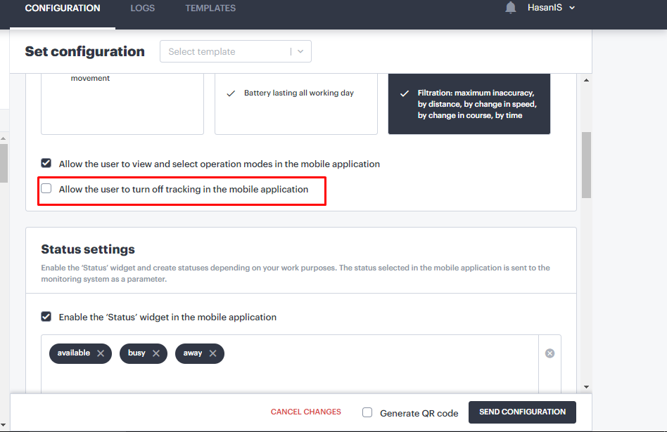

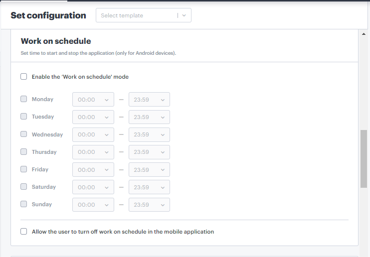

you can configure these devices remotely now, and one of the options is you can controll the holder of the wiatag and disable the ability to turn of the tracking in the app.
and if he said i want to turn it off after working hours to stop consuming charge from the phone, well you can set a working schedual

the link to configure the device is
http://configurator.s-watcher.com/config
