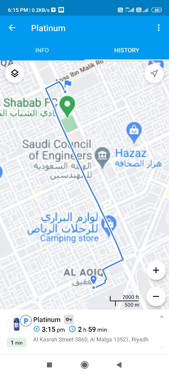

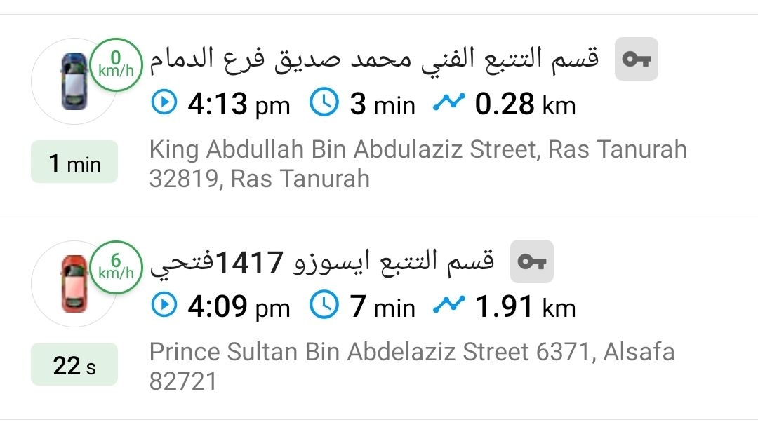

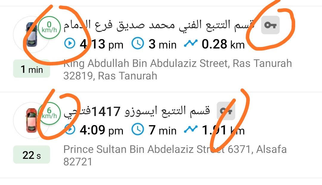

Hello Team
How i can get the attached screenshot details from the item search API
http://gps.tawasolmap.com/wialon/ajax.h … mp;params= {"id":20646,"flags":4611686018427387903}&sid=96d4c9e77d385ddf775f64d3c5dbd85b
As i have thought as per below please correct me if i am wrong
1) Name of the Unit                    items[0][nm]
2)Unit id                                      items[0][id]
3)Unit Latitude                            items[0][pos][x]
4)Unit Longtude                        items[0][pos][y]
) Speed of the Unit                     items[0][pos][s]
Date of last active
Engine status (On/Off)
Unit is in the parking or not
Last speed
How i can get from the above API if you
  • How to get Unit Last update date and time
Re: How to get Unit Last update date and time
Hello!
1) Last data information (unit name, speed, position, date/time) you can get via request search item (or search items ) with correspodings flags value.
2) Engine status , moving/parking status you can get via Events - trips and igntion
To get live events the steps are the following
  • Then execute request events/check_updates, for example every 2-5 sec, to get response with online data
For example
1. First (after login) it needs to add required units to session via request  svc=events/update_units
https://hst-api.s-watcher.com/wialon/ajax.html?svc=events/update_units&params={"mode":"add","units":[{"id":2147,"detect":{"ignition":0,"trips":0}},{"id":2174,"detect":{"ignition":0,"trips":0}}]}&sid=023078baa1999df1ea0da05cd4cbc9a02cb
"units" - units array where  'id' - unit's id, 'detect' - required events types, in our case only "ignition":0 and trips "trips":0, 0 means all ignition sensors, if you know that unit has only 1 ignition sensor, you can set up '0'.
If there is several ignition sensors it's better to set up sensor's id. But sure it depends on appropriate business task. For trips is always 0 ("trips":0).
It needs to specify for each units 'id' each 'detect' type.
2. After required units has been added to session, we can monitor online ingtion state via request events/check_updates which can be executed for example every 2 sec or rarely , it depends on how often the device sends data to the server
https://hst-api.s-watcher.com/wialon/ajax.html?svc=events/check_updates&params={"detalization":3}&sid=023078baa1999df1ea0da05cd4cbc9a02cb
"detalization":3  means that server will return  JSON information for flags plus

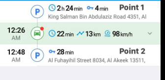

Thanks for your support
as I got below response with once I follow the above steps 1 and 2 and below response I got
I got ignition and trip array,
how I can get value under the unit image "11s"
Date and time with speed
All the movement of the unit on the selected date

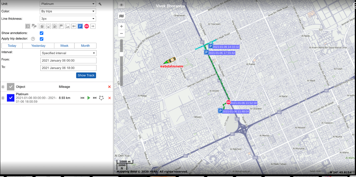

Hello!
You can get  "avg_speed" speed parameter, or "curr_speed": - current speed, parameter "m" shows the time of last message (Unix time UTC+0), the trip duration is calculated as difference between "from" and "to"

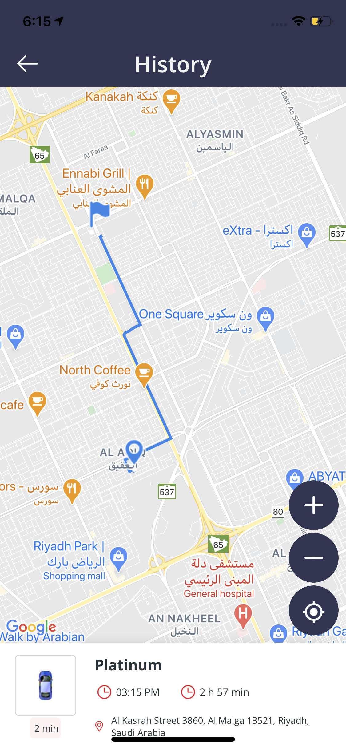

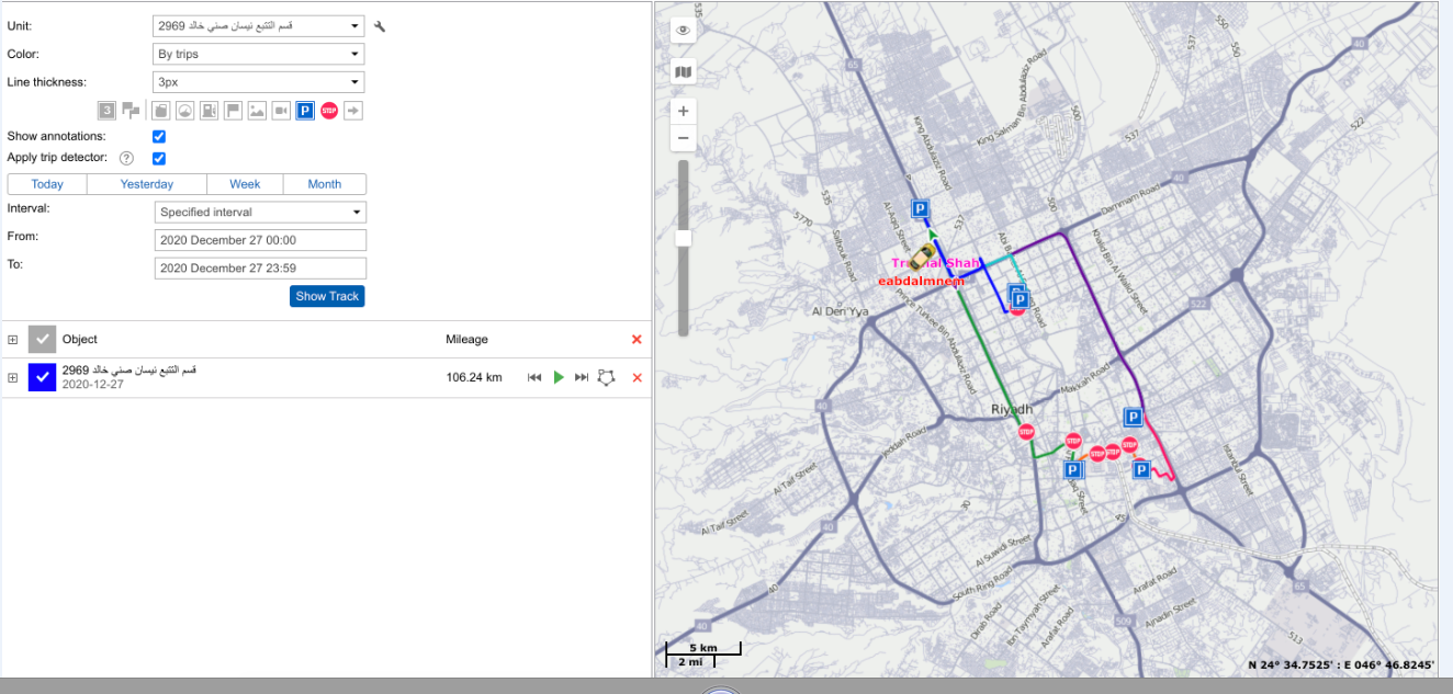

Thanks for the solutions,

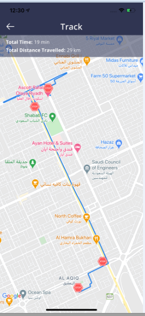

Last point that how I can get the movement of the units with start and [Between each] endpoint the day, or between dates
Hello!
To get history data of events (trips, ignition) you need to execute  events/load & events/get
First you load events for some period  - , then get  it
For example,
Get trips from Oct 1 - Oct 5 , unix time UTC+0
Load events
https://hst-api.s-watcher.com/wialon/ajax.html?svc=events/load&params={"ivalType":1,"itemId":214,"timeFrom":1601510400,"timeTo":1601942399,"detectors":[{"type":"trips","filter1":0}]}&sid=028384ac3f02f18c414208758685b320
Get result
https://hst-api.s-watcher.com/wialon/ajax.html?svc=events/get&params={"selector":{"type":"trips","timeFrom":1601510400,"timeTo":1601942399,"detalization":3}}&sid=028384ac3f028758685b320

If you can please help me to set the direction of the unit as i can see in the wialon app on the map each unit icon have a different direction, I am using google map to display unit
trushal.shah wrote:
Hi, thanks for the update
Good day!
To display direction we use the parameter course which device can send.
If your device type sends this parameter, you can get it from messages.
For example, pos: {y: 53.9058786, x: 27.4569481, c: 38, z: 302.700012207, s: 0, sc: 11}, where parameter 'c' is course , integer (from 0 to 359 degrees, where 0 - means North)

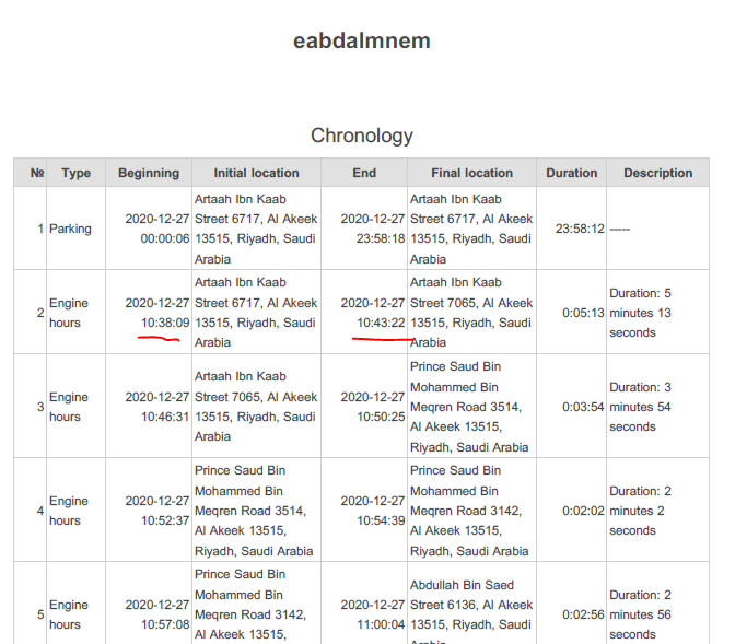

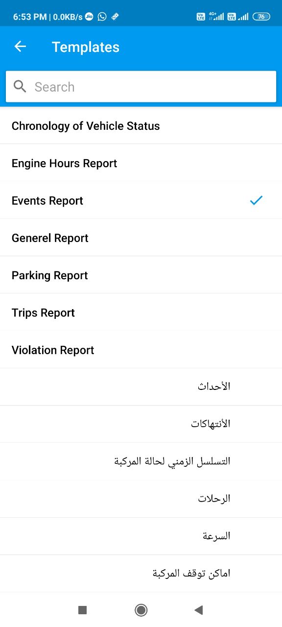

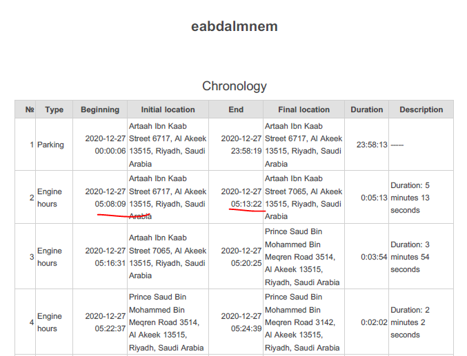

If you can please help me how i can get the report pdf file of the units same wialon App
1) Which API we can integrate to get all template to belong to the account
2) which API should help me to execute the report of the unit and in response get a pdf file with details of the movement with address
Please check I have attached two files
Hello!
1) To get all reports created in account via request search items or
search item by ID  with flags = 8193 ( base flag + 8192 reports data)
2) To execute report - please look example  https://sdk.s-watcher.com/wiki/en/sidebar/ … es/reports
3) After report executed you can export it to file - please look the request format here https://sdk.s-watcher.com/wiki/en/sidebar/ … ort_result

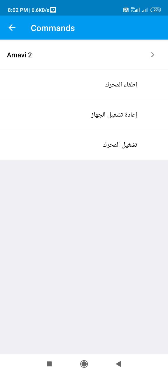

2) Also we are getting a
command list
"cmds": [
                    "n": "إطفاء المحرك",
                    "a": 1,
                    "t": "tcp,vrt",
                    "c": "custom_msg",
                    "p": "Out 0,0"
                    "n": "تشغيل المحرك",
                    "a": 1,
                    "t": "tcp,vrt",
                    "c": "custom_msg",
                    "p": "Out 0,1"
                    "n": "Arnavi 2",
                    "a": 1,
                    "t": "tcp,vrt",
                    "c": "custom_msg",
                    "p": ""
How I can execute these commands for example if there is commands like Engine start, Engine Off

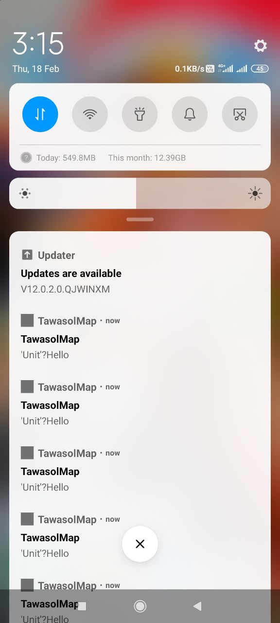

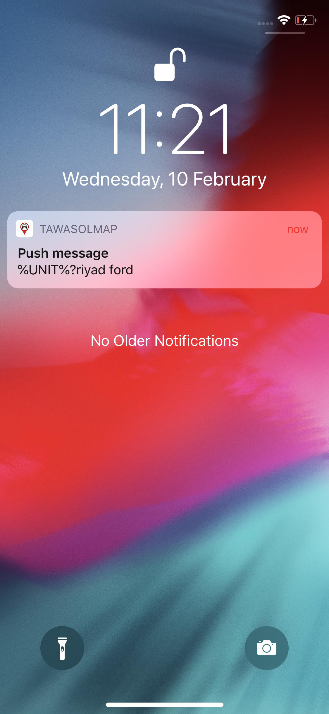

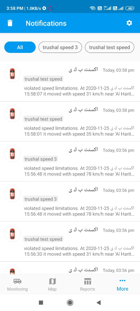

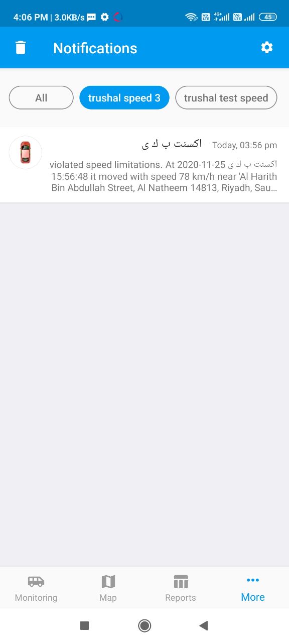

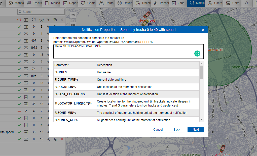

Hello Gurtam team
I stuck with at below APi request that my client request to  notification send to login user users as their engine is on, engine off, speed limit and geozone
How i can set notification with specific units
like
1)Unit engine is on and get mobile notifications
2)Unit engine is Off and get mobile notifications
3) Unit is running more then set speed
next is get all notification of the units same as current attached screenshots
http://gps.tawasolmap.com/wialon/ajax.html?svc=resource/get_notification_data&params={"itemId":55874,"col":]}&sid=c59a1d9fe2a4927c94d540dd190b6956
Hello!
As I understand you need to create the following notifications with required parameters:
1) Control engine is on, action  - get mobile notifications
If unit has Engine Ignition sensor, you can create notification to control sensor by type = Engine Ignition Sensor ("engine operation")
Use the following parameters:
{"n":"example engine On","ta":1603746000,"td":0,"tz":134228528,"la":"en","ma":0,"sch":{"f1":0,"f2":0,"t1":0,"t2":0,"m":0,"y":0,"w":0,"fl":0},"ctrl_sch":{"f1":0,"f2":0,"t1":0,"t2":0,"m":0,"y":0,"w":0,"fl":0},"un":[1326],"trg":{"t":"sensor_value","p":{"sensor_type":"engine operation","sensor_name_mask":"*","lower_bound":1,"upper_bound":1,"prev_msg_diff":0,"merge":1,"type":0}},"d":"","act":[{"t":"mobile_apps","p":{"apps":"{\"Wialon\":[1027]}"}}],"txt":" notification text","fl":0,"mast":0,"mpst":0,"cdt":0,"mmtd":3600,"cp":3600,"id":28,"itemId":930849,"callMode":"update"}
2) Control engine is Off, action  - get mobile notifications
The same parameters as above, just change value range to 0 - "lower_bound":0,"upper_bound":0
3) Speed limit (the action as above)
{"n":"example1","ta":1603746000,"td":0,"tz":134228528,"la":"en","ma":0,"sch":{"f1":0,"f2":0,"t1":0,"t2":0,"m":0,"y":0,"w":0,"fl":0},"ctrl_sch":{"f1":0,"f2":0,"t1":0,"t2":0,"m":0,"y":0,"w":0,"fl":0},"un":[826],"trg":{"t":"speed","p":{"sensor_type":"","sensor_name_mask":"","lower_bound":0,"upper_bound":0,"merge":0,"min_speed":0,"max_speed":60,"driver":0}},"d":"","act":[{"t":"mobile_apps","p":{"apps":"{\"Wialon\":[1427]}"}}],"txt":" notification text","fl":0,"mast":0,"mpst":0,"cdt":0,"mmtd":3600,"cp":3600,"id":28,"itemId":849,"callMode":"update"}
where "min_speed":0,"max_speed":60 is allowed range.
4) Geofences control - in geofence ("type":0)
{"n":"example geo","ta":1603746000,"td":0,"tz":134228528,"la":"en","ma":0,"sch":{"f1":0,"f2":0,"t1":0,"t2":0,"m":0,"y":0,"w":0,"fl":0},"ctrl_sch":{"f1":0,"f2":0,"t1":0,"t2":0,"m":0,"y":0,"w":0,"fl":0},"un":[1186],"trg":{"t":"geozone","p":{"sensor_type":"","sensor_name_mask":"","lower_bound":0,"upper_bound":0,"merge":0,"geozone_ids":"930849_40:1595402237","geozone_id":"930849_40:1595402237","type":0,"min_speed":0,"max_speed":0,"lo":"OR"}},"d":"","act":[{"t":"mobile_apps","p":{"apps":"{\"Wialon\":[1427]}"}}],"txt":"%UNIT% arrived to %ZONE%. At %POS_TIME% it moved with speed %SPEED% near '%LOCATION%'.","fl":0,"mast":0,"mpst":0,"cdt":0,"mmtd":3600,"cp":3600,"id":28,"itemId":949,"callMode":"update"}
5) To get all notification with their params
Use the request resource/get_notification_data , the empty "col":"" returns all notifications

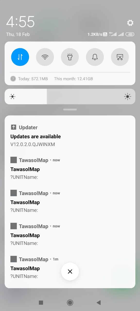

Hello, Team Thanks for the Replay,
Before I call this API, Which API should i need to call to set that this login customer would get push notifications, like that
like Customer ABCD login with the application after authentication success, there are three Units associate with customer
1. BMW
2. Audi
3. Toyota
Now customers want to set a notification on each unit start. stop and speed that I will use your example API,
But my query is how that customer will get push notification in his Device- the phone  is there an API call for that to get notification

Hello Team,
How to delete a group of units
like I have created a new unit group with API
http://gps.tawasolmap.com/wialon/ajax.html?svc=core/create_unit_group&params={"creatorId":58415,"name":"Reddd","dataFlags":1}&sid=75bb13461791e60dabe4ff590d8aee4
e
Add Unit in the group
http://gps.tawasolmap.com/wialon/ajax.html?svc=unit_group/update_units&params={"itemId":62282,"units":[2751,20646]}&sid=5c2ce8bcaa3a2222f14cea9665f770b7
Now i want to delete this group name Reddd, which APi should i use

2. Audi
3. Toyota
If you can please help in this also that how Notifications would work, like steps
Hello!
To send mobile notification (push-notification) there is not API, because the action is executed from back-end side in Wialon.
For this it needs to activate the corresponding action in notifications settings - Send mobile notification
or you can don't use the our functional, but realize something on your side.
chdi wrote:
Hello!
Push notification is not able to set as of with app, but as example I have set for the email and its works for the above example
for this simple text, i got a success message, but as i have set some dynamic as per that last example you have updated for the geozone same i have use for the engine status On
http://gps.tawasolmap.com/wialon/ajax.html?svc=resource/update_notification&params={"n":"example engine On","ta":1603746000,"td":0,"tz":134228528,"la":"en","ma":0,"sch":{"f1":0,"f2":0,"t1":0,"t2":0,"m":0,"y":0,"w":0,"fl":0},"ctrl_sch":{"f1":0,"f2":0,"t1":0,"t2":0,"m":0,"y":0,"w":0,"fl":0},"un":[20646,55304,54533],"trg":{"t":"sensor_value","p":{"sensor_type":"engine operation","sensor_name_mask":"*","lower_bound":1,"upper_bound":1,"prev_msg_diff":0,"merge":1,"type":0}},"d":"","act":[{"t": "email","p":{"email_to":"trushal.shah@brainvire.com","html":1,"img_attach":1,"subj":"TawasolMap Notification"}}],"txt": "Name of the Unit %UNIT% . At %POS_TIME% near '%LOCATION%' Engine Status is ON","fl":0,"mast":0,"mpst":0,"cdt":0,"mmtd":3600,"cp":3600,"id":6,"itemId":55874,"callMode":"update"}&sid=662b6d5cd6dccfecc01266b7604690df
getting error
    "error": 4,
    "reason": "WRONG_PARAMS"
i have set below text from your last example
Hello trushal.shah !
"txt": "Name of the Unit %UNIT% . At %POS_TIME% near '%LOCATION%' Engine Status is ON" - the special characters parameters, in this example %, should be URL-encoded - https://www.w3schools.com/tags/ref_urlencode.ASP
Please try to change % to  %25
PS. It's not advisable to provide sensitive real information like token, elements ID, session id. To check some your special case you can provide me this information via PM

Thank you for your reply, that is my query how i can get that report templates ids like which template belong to units and which is for the unit groups
i need this for the report page
If the reports templates ids are already known, you can get report type (unit or unit group) via request report_get_report_data
If no, you can get report templates ids and  template type via request search item - you need to search required resource where reports created and get information about report (flag for reports templates data  - https://sdk.s-watcher.com/wiki/en/sidebar/ … templates)
For example,  search resource by its name, flag = 8192 will return information about report templates

Thanks for replay
how i can use this "propValueMask":"1,*di*"
because with this i am not able to get data but if I set only with "propValueMask":"*" getting data
but getting  44 records but i can see there is just a few templates associate with an account with wialon mobile applications
please check the attached screenshot, i have taken from wialon application tab report click

Hello!
In "propValueMask" you can set up a full element name (mask), or part with * as mask, or leave :"*"  which means any name (any value).
For example, "propValueMask":"1,*di*"  means element with exact name '1' and elements' names contains 'di'
In my example above it's request to search element (resource) by 2 criteria ("propName":"rel_is_account,sys_name", "propValueMask":"1,*di*") : rel_is_account is 1 (account status) and sys_name (element name) contains 'di'
In your case you can apply full resource name in "propValueMask" - the system will search resource(account) by this name and return data about reports templates created in this resource.
Also you can search item only by 1 criteria (by name)
Thanks for all your message,
as your last update that we can not send a push notification with wialon API,
then how i can send any link or any  support that I can set in my application to get notification same as wialon does
also that how I can get a list of notification that user get on a set of notification
i have attached three screenshots that I need to integrate this flow in my current application how i can do that which APi should is use
1) get List of notifications as per request
2) Any support URL that i can integrate to set push notifications the same as wialon app
thanks for your support again

Hello trushal.shah!
could you please write me to email chdi@gurtam.com , that we can discuss about some details regarding your app.
Hello!
For example,

Thanks for your reply,
its works for us to get some movement of the unit with the center of the day but I am not getting if in the parking with start and endpoint
The first trip end time (to time) will be the starting of the parking time(from the time) and the second trip start time will be the end time of the parking event and so on we are calculating parking detail between all the trips.
1. How we can calculate the first parking event of the day which is shown in the attached image as point 1
2. How we can calculate the last parking event of the day which is shown in the attached image as point 2
- If it is the same day event then we are considering the current time as the end time of the last parking event, but for the last day we have considered the end time of the day 11:59 PM but we are not able to calculate that data
Hello!
1. To calculate the first parking in day it depend on your goal, for example you can group events by days, so the day starts from 00:00 to 23:59
and cut the event by begin/end of day.
So to calculate first parking you just calculate time from 00:00 to start 1st trip.
2. The last parking event you can calculate by the end of the day (23:59) , if the day was at history. If it's current day you can calculate by current time
For example, the last trip was end at 09:00 AM, now current time is 9:31, so the current parking is 32 min

This is working for us properly , Here how we should manage engine status for below conditions how we should get flags in the response of this
Hello if you can please help me to get unit engine status with the bellow cases
How i can get it from API
1) Add key next to the icon when the engine starts it : Green with key when Vehicle is moving and the engine is on,
2) Red with key when the Vehicle stop and the engine is on,
3) Green only if the Vehicle moving without start engine so no key in this situation & red without key if the Vehicle stops and the engine off.
what we have considered that if speed is > 0 then engine status is ON and Speed = 0 then engine status is off but how we should calculate that speed with and engine status with current screens shots

Hello I need to know that as suggested API to get history of trips and its workig like charm, but here we get differet on display rooth path on the map,
svc=events/get
get a response from APi with start and end location
"trips": {
        "0": [
                "from": {
                    "t": 1608526381,
                    "y": 24.7762775421,
                    "x": 46.6249923706
                "to": {
                    "t": 1608527106,
                    "y": 24.7713947296,
                    "x": 46.6237869263
and we use this start and end location as in the below API of the google
https://maps.googleapis.com/maps/api/directions/json?origin=\(source.latitude),\(source.longitude)&destination=\(destination.latitude),\(destination.longitude)&sensor=false&mode=driving&key=\(API_KEY)")
but we are getting the wrong path to compare to Wialon track location path at history page ,
if you can please help me that how i can get this root location from start to endpoint
Hello!
The Wialon is displayed track using Google Polyline Algorithm
When you request trips events, you can get such track in parameter  , just add flag ("detalization")  = 8
For example,
https://hst-api.s-watcher.com/wialon/ajax.html?svc=events/get&params={"selector":{"type":"trips","timeFrom":1601510400,"timeTo":1608551874,"detalization":9}}&sid=06f3f79ddfad80414a4db
Response
{"trips":{"0":[{"from":{"t":1608377059,"y":46.8571205139,"x":-122.974449158},"to":{"t":1608377259,"y":46.826374054,"x":-122.963294983},"m":1608377483,"f":2,"track":"_x~|GfmqmV??????lo@wdA????vnC?????"},{"from":{"t":1608379499,"y":46.826374054,"x":-122.963294983},"to":{"t":1608379749,"y":46.8789367676,"x":-122.876327515},"m":1608379749,"f":2,"track":"ywx|GngomV??????????????ogI??o~O??"}
Then you can decode 'track' via Google Decode Polyline

Hello thanks for your support
In the report, I request
Between date from 27/12/2020 00:00 AM
Between date To 27/12/2020 11:59 PM
exec_report API:
{"reportObjectSecId":0,"reportObjectId":20306,"interval":{"flags":0,"to":1609113599,"from":1609027200},"reportResourceId":"62290","reportTemplateId":1}"
exec_result API
"extendBounds":0,"pageWidth":0,"format":2,"headings":0,"coding":"utf8","pageSize":"a4","pageOrientation":"portrait","delimiter":"semicolon","attachMap":1,"outputFileName":"eabdalmnem_27/12/2020","hideMapBasis":1,"compress":0}
Above both API working and we are getting report as PDF file
But here the issue is we are not getting proper data with the above post formates
we use to get date as UTC time [timeFormatter.timeZone = TimeZone(abbreviation: "UTC")]
Please check two diff response screenshots
Initial location, Final location, Duration this data are coming proper
But Beginning time and End time coming wrong

By default report result has UTC+0 timezone.
To apply user's timezone to report result, after login it needs to execute request  render/set_locale
Then you can execute reports, get PDF file.
For example, timezone +5.30 = "tzOffset":134237528
"tzOffset" value includes DST settings (no DST = 0x08000000 = 134217728 )
https://hst-api.s-watcher.com/wialon/ajax.html?svc=render/set_locale&sid=02b93b7a37e3ce1510908253b4db8902
params: {"tzOffset":134237528,"language":"en","flags":256,"formatDate":"%m-%E-%Y %H:%M:%S"}
Note: also it may need to url-encode special symbol %

thanks for the response,
Here if the customer location is in Saudi Arabia and maybe a different location then do we need to update each time different time zone

How to execute a command for different requests
With search_item API we got different command and each command have different execution, on which flag we set a condition to user selection
core/search_item&params={"id":29916,"flags":512}
    "item": {
        "cmds": [
                "a": 1,
                "t": "tcp,gsm,vrt",
                "c": "custom_msg",
                "p": "Out 1,0"
                "a": 1,
                "t": "tcp,gsm,vrt",
                "c": "custom_msg",
                "p": "Out 1,1"
                "n": "Arnavi 2",
                "a": 1,
                "t": "tcp,gsm,vrt",
                "c": "custom_msg",
                "p": ""
                "n": "إعادة تشغيل الجهاز",
                "a": 1,
                "t": "tcp,gsm,vrt",
                "c": "custom_msg",
                "p": "reset"
    "flags": 512
1) Sent message option to execute a command
2) Reset option to execute the command
3) simple Execute commands
How i can differenciate this response value of t,c and p for different units,
svc=unit/exec_cmd&params={"itemId":55873,"commandName":"custom_msg","linkType":"tcp,gsm,vrt","param":"","timeout":10,"flags":0}

Hello
Thanks for your support,
if you can please support us for below query
Event Load:
{"ivalType":1,"itemId":54533,"timeFrom":1609007400,"timeTo":1609093799,"detectors":[{"type":"trips","filter1":0},{"type":"ignition","filter1":0}]}
Get Event
svc=events/get&params={"selector":{"type":"*","timeFrom":1609007400,"timeTo":1609093799,"detalization":11}}
Here how we can get stop details of the unit movement for track pages
please check the screenshot, we need to display the same stop icon on the map
Hello!
The Stops are the part of trips where speed is less than min value speed in Trip Detector. So if you need stops intervals you can request events trips with selected speed (custom intervals expressions)
For example, the min speed value = 1 km/h, so "expr":"trips{s<1}" means intervals where speed (s) less than 1 km/h
First load trips
https://hst-api.s-watcher.com/wialon/ajax.html?svc=events/load&params={"ivalType":1,"itemId":21728414,"timeFrom":1609718400,"timeTo":1609804799,"detectors":[{"type":"trips","filter1":0}]}&sid=02b93b7a37e3ce1510908253b4db8902
Then request intervals with speed < 1 km/h
https://hst-api.s-watcher.com/wialon/ajax.html?svc=events/get&params={"selector":{"expr":"trips{s<1}","timeFrom":1609718400,"timeTo":1609804799,"detalization":1}}&sid=02b93b7a37e3ce1510908253b4db8902
Response
{"trips":{"0":[{"from":{"t":1609753417,"y":43.3473701477,"x":-8.48857975006},"to":{"t":1609753448,"y":43.2673683167,"x":-8.48857975006},"m":0,"f":0},{"from":{"t":1609753490,"y":43.2673683167,"x":-6.4885802269},"to":{"t":1609753530,"y":43.1673698425,"x":-6.34601783752},"m":0,"f":0},{"from":{"t":1609754439,"y":42.4268341064,"x":-8.6491394043},"to":{"t":1609754439,"y":42.4268341064,"x":-8.6491394043},"m":0,"f":0}]}}

Hi, thanks for the reply
we got the response trips{s<1} with this condition but same time we need trips data also
so how I can get all movement of the vehicle with stop, parking, and  trips in single response
Hello!
There is not parking intervals in response.
You can get only trips, and trips with less speed (stops).
The parkings are calculated as difference between trips time.
First load, then get all full trips, and then get trips intervals (with speed less) as stops.
https://hst-api.s-watcher.com/wialon/ajax.html?svc=events/load&params={"ivalType":1,"itemId":21728414,"timeFrom":1609718400,"timeTo":1609891199,"detectors":[{"type":"trips","filter1":0}]}&sid=026499c89bc755056c401314b35bfa9f
https://hst-api.s-watcher.com/wialon/ajax.html?svc=events/get&params={"selector":{"type":"trips","timeFrom":1609718400,"timeTo":1609891199,"detalization":1}}&sid=026499c89bc755056c401314b35bfa9f
https://hst-api.s-watcher.com/wialon/ajax.html?svc=events/get&params={"selector":{"expr":"trips{s<1}","timeFrom":1609718400,"timeTo":1609891199,"detalization":1}}&sid=026499c89bc755056c401314b35bfa9f
All 3 requests can be execute at one svc=core/batch
Format like
https://hst-api.s-watcher.com/wialon/ajax.html?svc=core/batch&sid=026499c89bc755056c401314b35bfa9f&params={"params":[{},{},{}]}
where JSON object in array is a request {"svc":"...","params":{...}}
Example
https://hst-api.s-watcher.com/wialon/ajax.html?svc=core/batch&sid=026499c89bc755056c401314b35bfa9f&params={"params":[{"svc":"events/load","params":{"ivalType":1,"itemId":21728414,"timeFrom":1609718400,"timeTo":1609891199,"detectors":[{"type":"trips","filter1":0}]}},{"svc":"events/get","params":{"selector":{"type":"trips","timeFrom":1609718400,"timeTo":1609891199,"detalization":1}}},{"svc":"events/get","params":{"selector":{"expr":"trips{s<1}","timeFrom":1609718400,"timeTo":1609891199,"detalization":1}}}],"flags":0}
The response will contain full trips (in example 5 full trips) and stops intervals (in example 6 intervals)
[{"events":{"trips":{"0":5}},"states":{"trips":{"updateTime":1606694400}},"selector":{}},{"trips":{"0":[{"from":{"t":1609740136,"y":46.8365631104,"x":-2.789290905},"to":{"t":1609740381,"y":46.3055648804,"x":-2.789290905},"m":1609740681,"f":2},{"from":{"t":1609747691,"y":46.3055648804,"x":-2.789290905},"to":{"t":1609748071,"y":43.3003921509,"x":-2.0059273243},"m":1609748385,"f":2},{"from":{"t":1609748558,"y":43.3003921509,"x":-2.0059273243},"to":{"t":1609748851,"y":43.4693832397,"x":-3.83861064911},"m":1609749180,"f":2},{"from":{"t":1609749642,"y":43.4693832397,"x":-3.83861064911},"to":{"t":1609750584,"y":43.3473701477,"x":-8.48857975006},"m":1609750884,"f":2},{"from":{"t":1609753417,"y":43.3473701477,"x":-8.48857975006},"to":{"t":1609754439,"y":42.4268341064,"x":-8.6491394043},"m":1609754768,"f":2}]}},{"trips":{"0":[{"from":{"t":1609740321,"y":46.3055648804,"x":-2.789290905},"to":{"t":1609740351,"y":46.3055648804,"x":-2.789290905},"m":0,"f":0},{"from":{"t":1609747781,"y":46.2055625916,"x":-2.98929095268},"to":{"t":1609747981,"y":43.3233222961,"x":-2.00242733955},"m":0,"f":0},{"from":{"t":1609748041,"y":43.3003921509,"x":-2.0059273243},"to":{"t":1609748041,"y":43.3003921509,"x":-2.0059273243},"m":0,"f":0},{"from":{"t":1609748588,"y":43.3103904724,"x":-2.0059273243},"to":{"t":1609748822,"y":43.4533843994,"x":-3.83861064911},"m":0,"f":0},{"from":{"t":1609750500,"y":43.3473701477,"x":-8.40155792236},"to":{"t":1609750500,"y":43.3473701477,"x":-8.40155792236},"m":0,"f":0},{"from":{"t":1609753595,"y":42.4268341064,"x":-8.6491394043},"to":{"t":1609754408,"y":42.4268341064,"x":-8.6491394043},"m":0,"f":0}]}}]
If you need to load trips from new interval, you need to execute request svc=events/unload, then load new intervals.

Hi, thanks for the reply this works
but still, there is wrong location data on the map of the parking and stop comparing with webpenal
All data under s>1 consider as stop with less than 5 min different
As we compare with backend penal and mobile few locations consider as parking is considered as stop in the mobile.
1)i have attached a file of the response
2) screenshot of the web model with stop and parking
3) Mobile same request data with stop and parking
which condition would make can get same stop and parking location as web track on the map

Hello
thanks for the reply,
Sure i will do share more details with API call, response and mobile view with webview
In the share screenshots different is that
all location which we get as stop in the API are considered as Parking in the web,
so just want to know how we can get parking data stop data from the API
do we need to add any type like ignition?
When data are get via events(or in reports proceeded), there is not parking or stops events type, only trips (motion) detected by unit Trip Detector
The parkings/stops system is calculated additionally (you cannot get them via some API) :
The parkings are intervals between trips
For example   1st trip - 10:20 - 11:20
2nd trip  11:50 - 12:30
So the parking is 11:20 - 11:50
The stops are intervals inside trips where the speed is less then value Min moving speed.
For example, 1st trips - 10:20 - 11:20  where speed is less than 1 km/h (default value Min moving speed)  in messages from 10:21 till 10:24, so 3 minutes is stop.

Hello
I do send this message to get track data of the unit same as wialon page
same as the first image and the second image
but we are struggling to get data. we applied the same login you suggest getting between time data
its not sufficient to get the same data as the web does we if we apply s<1 then we are getting all the stops which are not there in the website
below is API call we done
APi URL:
Dates select 11/01/2021 to 12/01/2021 and unit id as 11489
http://gps.tawasolmap.com/wialon/ajax.html?svc=core/batch&sid=bdfabd36adfb22323b0a292ceb799ed5&params={"params":[{"svc":"events/load","params":{"ivalType":1,"itemId":11489,"timeFrom":1609439400,"timeTo":1609525799,"detectors":[{"type":"trips","filter1":0},{"type":"ignition","filter1":0}]}},{"svc":"events/get","params":{"selector":{"type":"trips","timeFrom":1609439400,"timeTo":1609525799,"detalization":11}}},{"svc":"events/get","params":{"selector":{"expr":"trips{s<1}","timeFrom":1609439400,"timeTo":1609525799,"detalization":11}}}],"flags":0}
let me know token required
and also I have attached result we from API call
check attached images that we need same stop and parking would display as wialon web/track page has
Please help me with this would much appreciate
Hello!
The same different time interval in request  and on screenshot.
"timeFrom":1609439400,"timeTo":1609525799 :
Thu, 31 Dec 2020 18:30:00 +0000
Fri, 01 Jan 2021 18:29:59 +0000
On screenshot Jan 6, 00:00-18:00 (regarding users timezone).
You write about other dates Dates select 11/01/2021 to 12/01/2021
Sure you can get different result on different intervals.
You can open Developer Console and look which time(from/to) is passed in request to get track data.

Hello
if you can please help me that what would be the format of the URL to send push notification on engine On and Off
    "t":"push_messages",    /* action type */
    "p":{
        "url":<text>,        /* server name (port may be defined), start it with "http(s)" */
        "get":<bool>        /* request type: 1 - GET, 0 - POST */
this is what I have set but not getting a notification
https://localhost.ip/front/api/v1/send_push?user=username&msg='Hello'
Do we need to attache message to send push, ot Wialon server would send same which we had set on the text
trushal.shah wrote:
Hello
    "p":{
Do we need to attach a message to send push, to Wialon server would send the same which we had set on the text
Hello Diana
if you can please help me in this its working with fire notification from firebase with the below URL
https://serverURL/front/api/v1/send_push?user=brainvire1
Method:  GET
But I am not getting from penal which saws fire of few notifications
(edited by trushal.shah 10/02/2021 08:59:28)
Hi, thanks for the replay this working fine, and we are getting notifications
But if I set the URL as this then getting as attached screenshot notification
https://localhost/front/api/v1/send_push?user=brainvire&msg=%UNIT%
and our requirement is to send message same
%UNIT% violated speed limitations. At %POS_TIME% it moved with speed %SPEED% near '%LOCATION%'.
How I can set this if you can please guide me
Hi!
If you need to get  a full string as text messages,  you can specify at notification (notification's text)  parameter with JSON object
For example,  msg={"spec":"%UNIT% unit and so on %some_other_wialon_tags%"}
So server should get parameter 'msg' with JSON value, and parse this JSON
(edited by trushal.shah 18/02/2021 14:08:55)
Diana wrote:
Hi!
Thanks for the update
the issue is with Notification text with space is not working
"txt":"Helllo UNITName%UNIT%Current_Location: %LOCATION%Current_Time%CURR_TIME%"
Notification got just Hello text rest of the message skip due to space, if we have remove all space then its working
like this "txt":"HellloUNITName%UNIT%Current_Location:%LOCATION%Current_Time%CURR_TIME%"
trushal.shah wrote:
Diana wrote:
Hi!
"txt":"Helllo UNITName%UNIT%Current_Location: %LOCATION%Current_Time %CURR_TIME%"
like this "txt":"HellloUNITName%UNIT%Current_Location:%LOCATION%Current_Time %CURR_TIME%"
Hello!
Try to type  URL-encoding %20  instead space
Diana wrote:
trushal.shah wrote:
Diana wrote:
Hi!
Hello!
thanks for the reply but still looks its skip the notification text with space, even from penal also
txt: UNITName: %UNIT% Current_Location: %LOCATION% Current_Time %CURR_TIME%
encode text: UNITName%20%25UNIT%25%20Current_Location%20%25LOCATION%25%20Current_Time%20%25CURR_TIME%25
But still its skip with space
Hello!
As I said before, it's better to send text as JSON parameter string type, i.e notification text is like paramName={"spec":"%UNIT% unit and so on %some_other_wialon_tags% some text with spaces"}
Sure the server should parse parameter paramName as JSON
In any case you should look through server parsing which get message from Wialon.
For example, our push server parse  any text from Wialon notifications, and users get the same text on mobile as in web interface.

Can you help me with how I can execute this command [start engine"]?
http://localhost/wialon/ajax.html?svc=unit/exec_cmd&params={"itemId":11489,"commandName":"custom_msg","linkType":"tcp,vrt","param":"","timeout":1,"flags":0}&sid=04dfaf9bcf913b6fca84e821fb220b11
    "error": 5
"cml": {
                "1": {
                    "id": 1,
                    "n": "start engine",
                    "c": "custom_msg",
                    "l": "",
                    "p": "Juste un exemple",
                    "a": 1,
                    "f": 0
                "2": {
                    "id": 2,
                    "n": "stop engine",
                    "c": "custom_msg",
                    "l": "",
                    "p": "stop engine",
                    "a": 1,
                    "f": 0
                "3": {
                    "id": 3,
                    "n": "أمر جديد",
                    "c": "custom_msg",
                    "l": "tcp",
                    "p": "",
                    "a": 1,
                    "f": 0
Hello!
When you execute command you need to pass the same parameters which original command has, like link type, commandName and etc.
In your example,
"n": "start engine" - commandName
"l": "" - link type (empty value means 'Auto')
"p": "Juste un exemple" - specified parameters
So you need to execute request unit/exec_cmd with the following parameters
"params":{"itemId":11489,"commandName":"start engine","linkType":"","param":"Juste un exemple","timeout":1,"flags":0}

Hi thanks for the reply if I set this with APi i am getting "
Unrecognized:JUSTE un example"
and same from penal got this message
Command 'start engine' sent to unit 'Platinum'.
params={"itemId":11489,"commandName":"start engine","linkType":"","param":"TawasolMap","timeout":1,"flags":0}&sid=09fff31a9820105727644773ba146a80
Hi!
The device send this response to your command as I see on your screenshot, because there is not correct parameter 'Juste un exemple' for command. You need to send command (create command before for unit) with correct parameter for certain command. Please look to device's manual or request to manufacturer  which parameters are correct for this command type.
Maybe here on forum - https://forum.gurtam.com/viewforum.php?id=18  you can find helpful information

I just want to know how I can display Map on the report please check below API request
{svc=report/export_result, params={"format":2,"pageOrientation":"portrait","pageSize":"a4","pageWidth":0,"coding":"utf8","delimiter":"semicolon","headings":0,"compress":0,"attachMap":1,"extendBounds":0,"hideMapBasis":0,"outputFileName":"eabdalmnem_30-04-2021"}, sid=d628a7f4e54b4cb31c928154b234cbb8}
I had reviewed with hideMapBasis hide map layer: 0 - no, 1 - yes
"extendBounds":0
"hideMapBasis":1
"extendBounds":1
"hideMapBasis":1
"extendBounds":1
"hideMapBasis":0
extendBounds=0
hideMapBasis=0
Please find both files different only is right of the screenshot with map and left is without map.

1. If you need to attach map to the exported PDF file, you need to pass parameter "attachMap":1, "hideMapBasis":0
"hideMapBasis":1 means tracks and markers are shown on the blank background
"extendBounds":1 means option Squeeze in all graphics
For example, parameters for request  report/export_result
{"compress":0,"attachMap":1,"hideGoogleLinks":0,"extendBounds":0,"hideMapBasis":0,"pageOrientation":"landscap","pageSize":"a4","pageWidth":"0","coding":"utf8","delimiter":"semicolon","headings":1,"outputFileName":"Volvo_awesome_!gtest_Eco_driving_03-05-2021_14-38-20","format":2}
yes, this I do use to display running car on the map and its movement
but here I need to display his all past and current running movement on the Map
e.g I started my vehicle at 6 AM and I moves to continue for 5 hours, till 11 AM
and in between if I want to see his trip all position on the Map from 6 to 8 and still vehicle is moving,
Hello!
In this case to get all messages from event you can pass digitalization  flags 16 plus 8 , for example total  "detalization":25
The response
"msgs":[{"tm":1454479860,"x":38.4273986816,"y":65.6319351196,"z":30,"c":18,"m":0,"s":10}...], // all messages
"track":"qvqoKejpiFkG??mIaAlI?{Sg^zSyS?"}} // track in Google notation https://developers.google.com/maps/docu … ineutility
