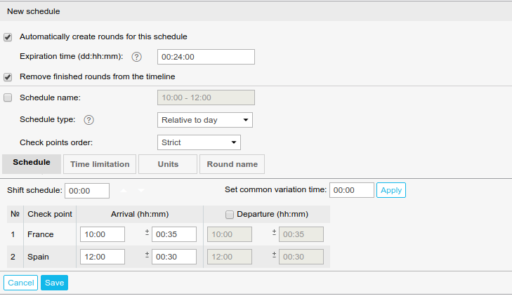

The full list of parameters for schedule  is here
For example, the response below can create the following schedule as on attached image
https://hst-api.s-watcher.com/wialon/ajax.html?svc=route/update_schedule&sid=02186bbd5c950e0e55ea09231367e10e&params={"n":"10:00-12:00","f":2,"tz":134228528,"u":20685653,"tm":[{"at":36000,"ad":2100,"dt":36000,"dd":2100},{"at":43200,"ad":1800,"dt":43200,"dd":1800}],"sch":{"f1":0,"f2":0,"t1":0,"t2":0,"m":0,"y":0,"w":0},"cfg":{"name":"roundName","units":[20685653],"enabled":1,"roundFlags":2,"autoName":0,"validityPeriod":86400},"itemId":20738013,"id":0,"callMode":"create"}
where
  "n":"10:00 - 12:00", /*schedule name */
  "f":2, /*schedule type, 2 = relative to day */
  "tz":134228528, /*user timezone = UTC+3 */
  "u":20685653, /* unit appointed to this round */
  //time of passing points, unix
  "tm": [
    //first point
      "at":36000,  /*arrival time, means 10:00 */
      "ad":2100, /*deviation from arrival time, means 35 min */
      "dt":36000, /*departure time */
      "dd":2100 */
    //second one
      "at":43200, /*12:00 */
      "ad":1800, /*30 min */
      "dt":43200,
      "dd":1800
  //time limitation, without any
  "sch": {
    "f1":0,
    "f2":0,
    "t1":0,
    "t2":0,
    "m":0,
    "y":0,
    "w":0
  //custom configuration
  "cfg": {
    "name":"roundName", /*route name */
    "units": [
      206 /*unitId to create rounds automatically */
    "enabled":1, /* 1 means to create rounds automatically */
    "roundFlags":2, /* round flags, 2 = strict order + remove finished rounds from the timeline */
    "autoName":0,
    "validityPeriod":86400 /* validity period to control = 24 hours */
  "itemId":207,//route ID
  "id":0,
  "callMode":"create"
