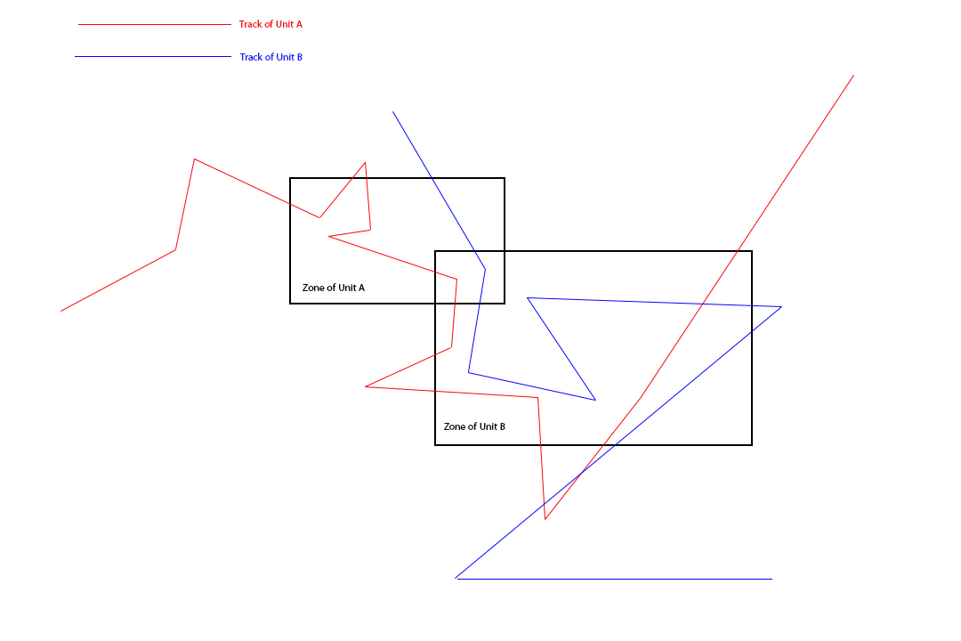

Still Isn't clear ? Let's take a look at attached image. I guess elements in images are clear. Now let's think that a company has 2 units, A and B, and also has 2 geofence each one related to one of those units. We create group of units A and B and call it The Group. Now we execute a geofence report on The Group. In results we have information about what happened for unit A inside geofence of unit B (that is not useful or important for us) and also what happened for unit B inside geofence of unit A (that is not useful or important for us). Now consider that we have 500 vehicles and 3500 geofences, lots of usefulness information will be reflected on report results.
It's logical to create 7 reports and set time limitation based on days of week. But still we will have 500 units and 500 geofences for each day (or better to say for each report template) with lots of usefulness and messy information in report result.
With Binding Geofences to Units we are going to solve this big problem.
