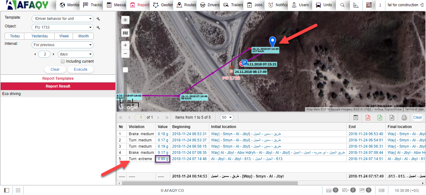

Okay. so we need to add ECO driving as a notification. not as a report only. when the car made the accident. the system gave me" turn extreme" with a value of G= 0.9 as you see in the pic. so what about in gurtam make the notification for the value of G without using any sensor . and this value will detect for an accident that may occur or no but it used to make attention for the unit and after received the notification we will call the driver. if he doesn't replay it probably has an accident so we will move to him.

zayedsaid14 You can create the sensor, for example if accelerometer value more than 1.5g (depending on your tracker's model it can be different parameter), activate the Crash sensor and create notification basing on this sensor.
