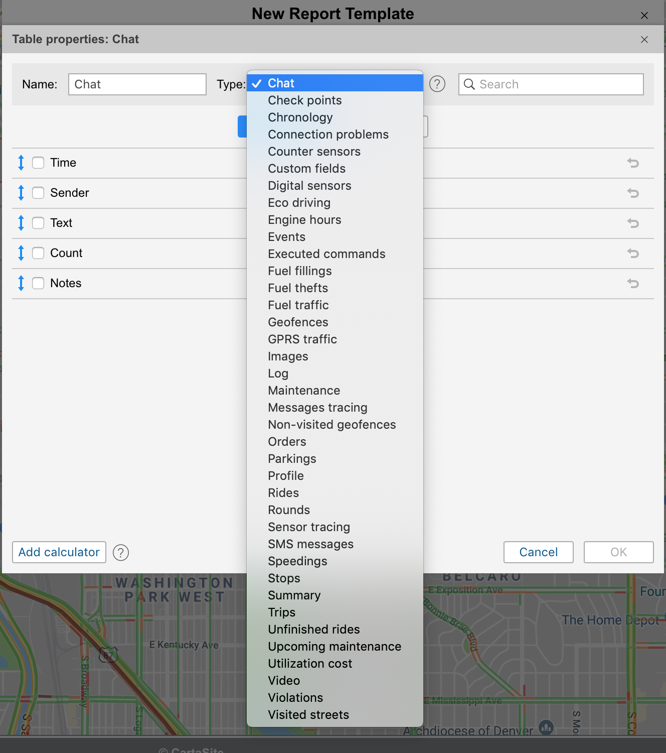

But using the report template does not provide a option to include all the units at once. You can create the report template once but when new units come in then again you need to add them , right ?
Also we have select "UNIT" type report but what we need to included in sub type (See attachment) ? We want to get all the events for all events with the eco driving and speeding events too.
