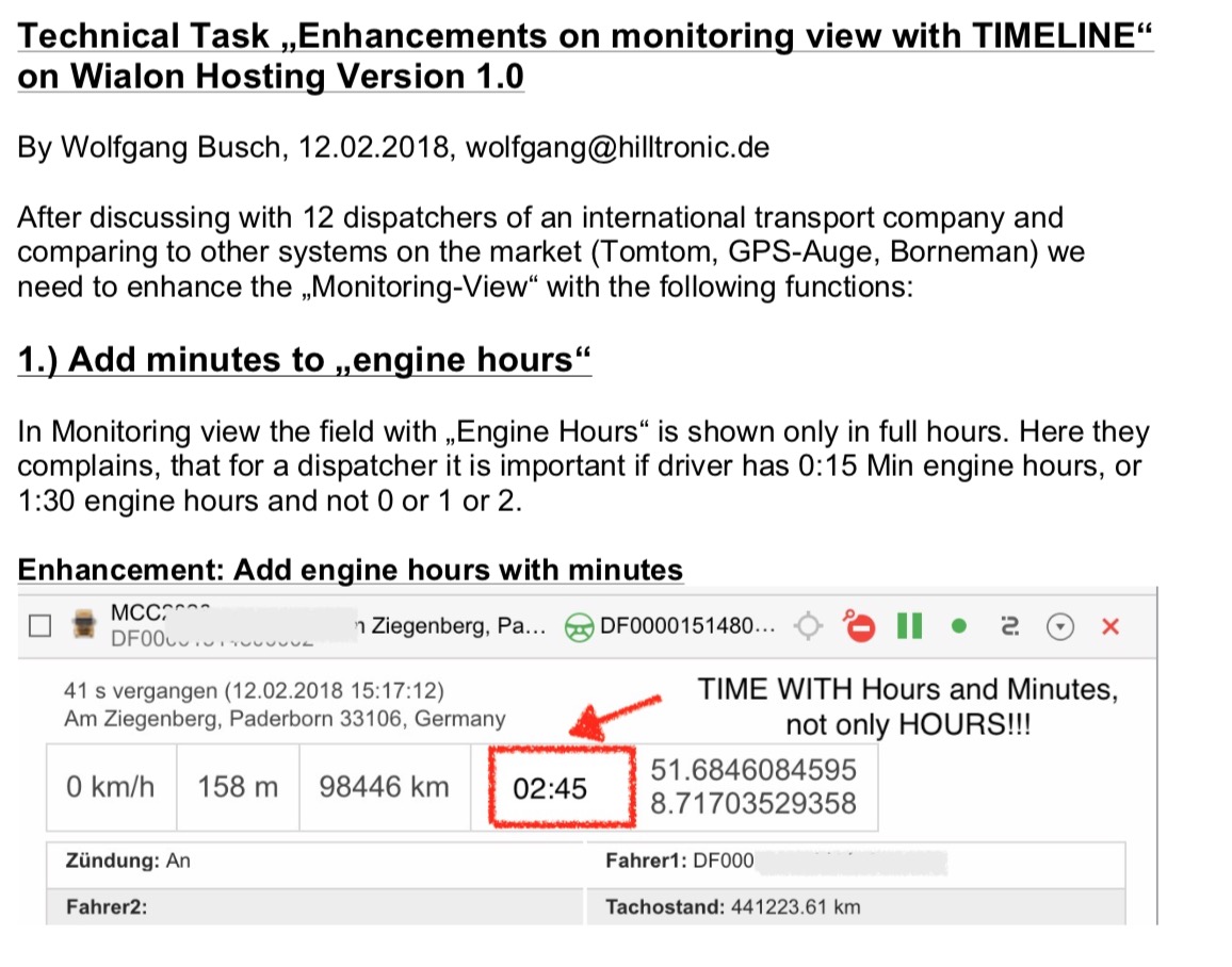

Hi Maksim.
uff, long time ago and still super actual and importand for us, let me attach my little technical task with request to comment.
(and dear other Partners, read carefully and comment).
(shit can not upload PDF file here, will attach pictures)
Thanks
Wolf.
ok, here is dropbox link
https://www.dropbox.com/s/pd0l3c5of0xeb … E.pdf?dl=0

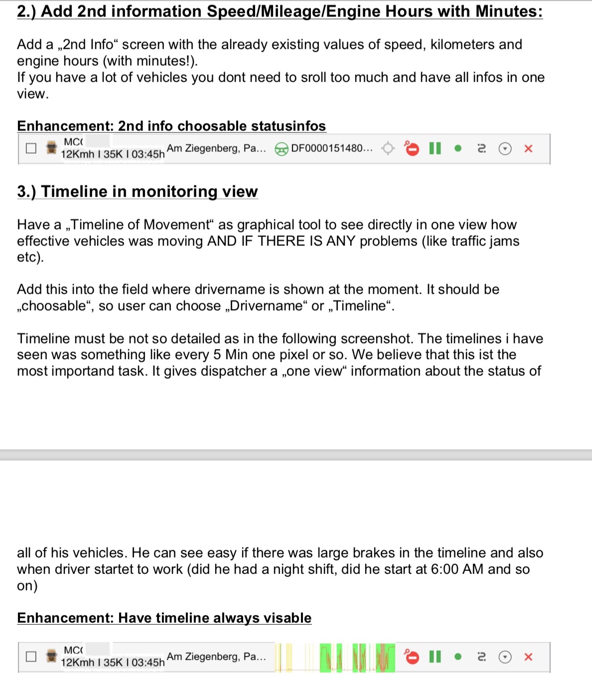

Dispatcher must see times fast way to choose which truck can they give next load, which one has enough and too much hours.
Just make an idea a person controlling a lot of trucks receiving calls the whole time and calling at same time giving trips.
Just an idea, it could add here the chart about driving times: http://prntscr.com/ieb0nu
sorry about the drawing but i think the idea can be understood.
this would be good to be sincrhornized when displying the rout so I could click in the stop or driving column and this would be shown in the map route displayed....

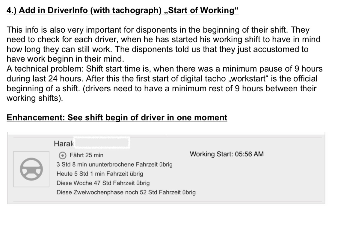

You have good ideas, and almost all of them are clear, but I need a small clarification for one point:
1) "Start of working":
You described a situation with a tacho. So, I need more detailed information how will we have to analyse this time ("Start of working") in different cases:
- if a driver does not have a minimum rest of 9 hours during last 24 hours.
- if we do not have a tacho.
When you give me all information, I will suggest you our solution for these ideas.

Hi Maksim,
i know that this is a problem as there are so many solutions on the road that does not have same HW as we use in "Europe".
I think we have 3 different situations:
1.) Vehicle has a digital tachograph and is in the EU driving --> we need to use the EU rules for this which means:
"A start of work = the first time the digital Tachograph switches to "Workmode" (there is a statusparameter that is 0,1,2 or 3, all above 0 = working mode) AFTER a UNINTERUPTED TIME OF 9 Hours in Mode0. I know, this works only if driver is using the same vehicle and not switching between vehicles. This (seldom) situation will not be solved. So lets think driver is always on the same vehicle.
To answer your first question: if driver had NO pause of 9 hours the working start time is again after the first pause of 9 hours. (i would set the search window to 24 hours. if he had no pause longer than 9 hours in last 24 hours i would write "unknown" or so.
2.) If there is no tacho we can use the standard schemes of Wialon, manual connection of driver to a vehicle and than i would use following algorithm:
"Working-Starttime= if vehicle changes location (trip detection) the first time after a pause of 9 hours in the last 24 hours where pause= vehicle is not moving". I think this algorithm has to be checked with other partners if it makes sence.
3.) No driverinfo: no working start :-))))
Wolf.

Thanks for the explanation. Now it is clear
We reviewed 3 of 4 ideas which you shared with us.
Point "Timeline in monitoring" was not reviewed. The reason is as follows:
- Firstly, I understand that it is one of the essential features for you but the information, which you need, can be obtained only by request "exec_report". We added new limitations "No more than 200 executions within 5 minutes by a user from one IP address" not so long ago. It was the necessary measure because we needed to reduce the load on our servers.
What did I want to say...each graphical tool for each unit will call request "report/exec_report". That's why a user will reach this limit quickly. And of course, we will face a high load of servers again, if every user wants to have this graphical tool.
One good news that we will add minutes to "Engine hours" in one of the nearest updates.
