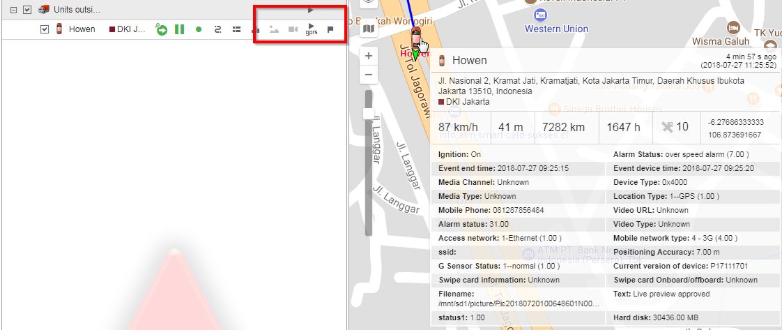

good day All
please how to configure ignition with howen device on Wialon and Ecodriving? i use Hero-ME41-04
Regards
Video monitoring in Wialon
Re: Video monitoring in Wialon
rostand wrote:
good day All
About ignition parameter please see the video:
https://gurtam.com/en/gps-hardware/auto … cification (don't pay attention on server ip, it can be different for your video server).
But parameters mask 1023 is correct. After that you can set up ignition sensor in Wialon.
About eco driving -- Howen doesn't transmit accelerometer. You can set up eco driving by GPS parameters only.

good day All
Yavi
the video we have from the link does not show how to configure ignition sensor. I would like to know how to use parameters to configure ignition sensor.
thank
rostand if you set up bitmask 1023 device will send all possible parameters.
Ignition (ACC) is transmiteed in the "status1" parameter
https://gurtam.com/en/gps-hardware/auto … parameters
In wialon bits start from 1 (not from 0) that's why you should set up the sensor basing on "status1:1" parameter.
Please learn more about bitwise parameter control:
https://docs.s-watcher.com/en/hosting/cms/ … sors/param
Viktor Yarovenko
