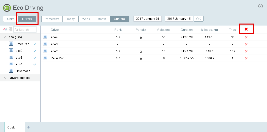

The new version of EcoDriving was released today.
We added the button to clear the list of elements.
And now can you visualize trips and violations not only for cars but also for your drivers.

Hello Tata ...
There is an issue when we want to choose "drivers", there are several drivers that we cannot select (they show in gray color); see the attached picture, we marked with red squares all the drivers we cannot choose.
We choose "last month" where most of them have worked and we cannot select most of the drivers either.
Are we doing something wrong or is there an issue?

Re: Eco Driving App improvement
P.S. Thanks for approving the Google layers! Yes we do have custom DNS, sure it will work.
Thanks for your notice. Seems it's a bug. We'll fix it soon.
And Google layers are not approved yet, I'm sorry for misleading you. My answer meant that your proposal is clear and we will think about it.
Please, check it.
Thank you once more for your activity.
tata wrote:
And Google layers are not apprved yet, I'm sorry for misleading you. My answer meant that your proposal is clear and we will think about it.
Tata- We have this same issue- unable to add drivers to list and some drivings on the list does not show activity when we know this should be. Did not notice this post before trying demonstrate this morning to customer.  Can you please advise what the status is on correction.  Also- does this affect ecodriving reports based upon drivers in monitoring?  Thank you.
fleetlogik , please, send more details to our support team, we will check your case more accurate, as our specialists couldn't find any problems by your description.
Thank you
Tata- development team looking into issues.
One point we discovered that may be of interest to others trying to add drivers to the list:  Note "double clicking" on the driver does not add to the work list.  You must use the "arrow" to add.  This is different behavior than unit list where either the arrow or double clicking will add the units to the work list.
fleetlogik , thank you! For sure, we will add double click for adding drivers to the list.
Edited: the fix is ready in the release version
